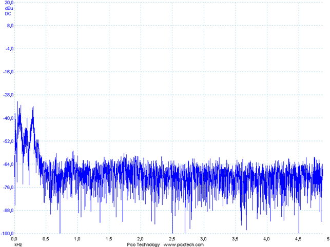

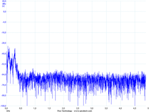

After a thorough research we found a way to make the carbon fiber armwand’s acoustic properties close to ones that normally are typical for the wood.
By using soft wood to damp the carbon fiber tube, our new armwand’s acoustic properties become considerably better than using carbon fiber alone, and can be compared to wooden armwands.

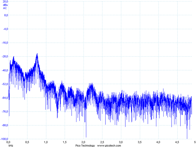

Differences between acoustical properties of damped and undamped carbon fiber wand are shown in Figures 1 and 2.
Figure 1. Damped carbon fiber.
Figure 2. Carbon fiber.

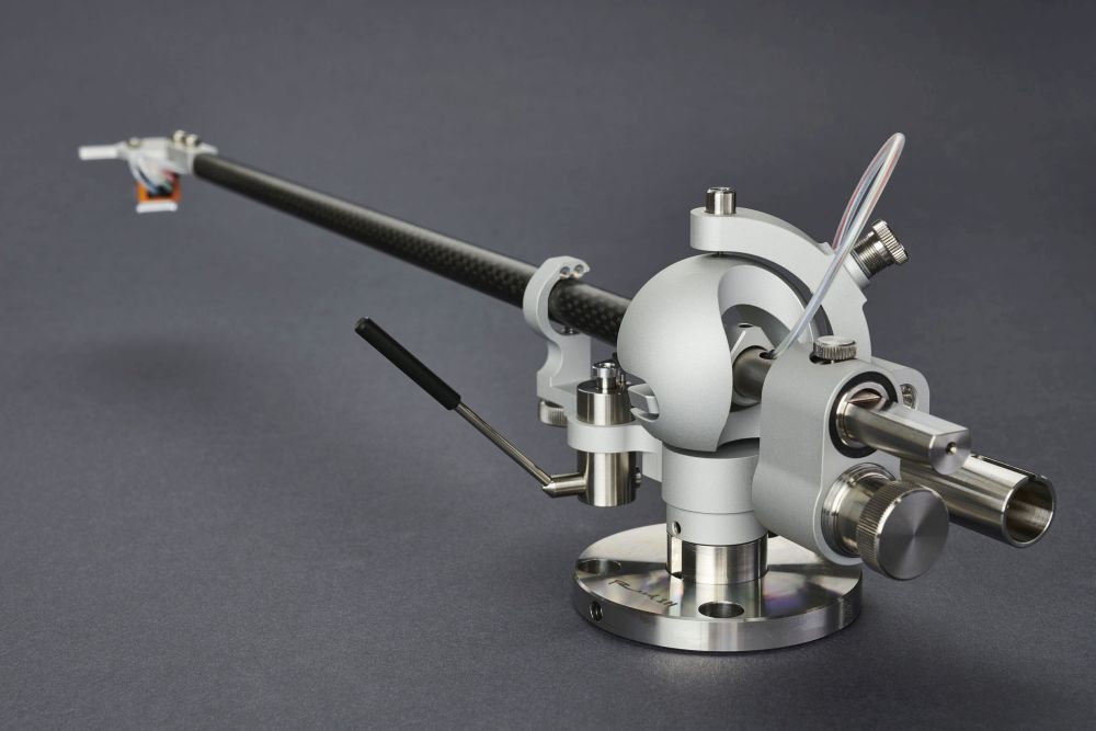

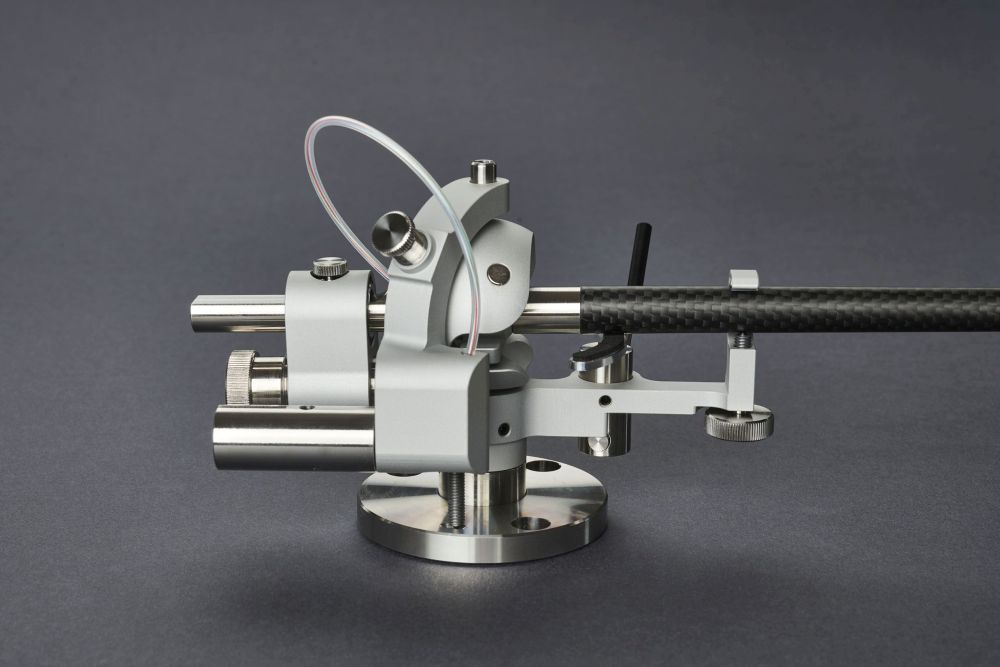

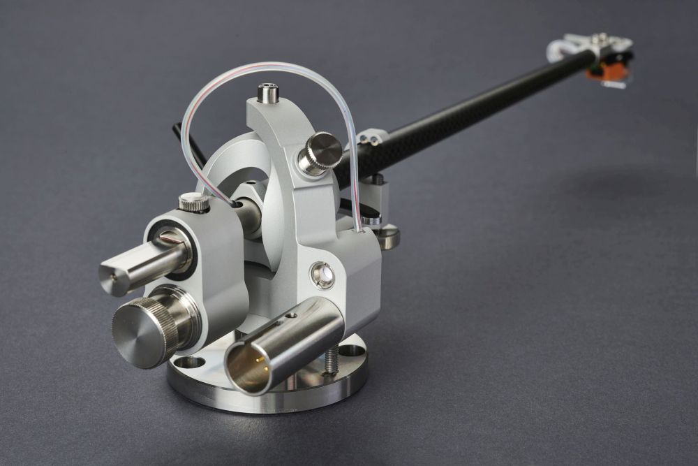

Reed 1H has a cardanic bearing system: vertical axis has thrust rotation bearings and horizontal axis is based on thrust pivot bearings (same concept as in Reed 3P). Such bearing construction eliminates wobbling of a bearing, which has a great impact on the quality of the sound.
Among other features, Reed 1H tonearm has azimuth adjustment, replaceable headshell and VTA adjustment. Tonearm height adjustment range is from 28mm to 48 mm. It is also easily tuned and can be mounted on most turntables out of the box or using an adapter.
