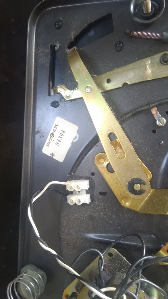

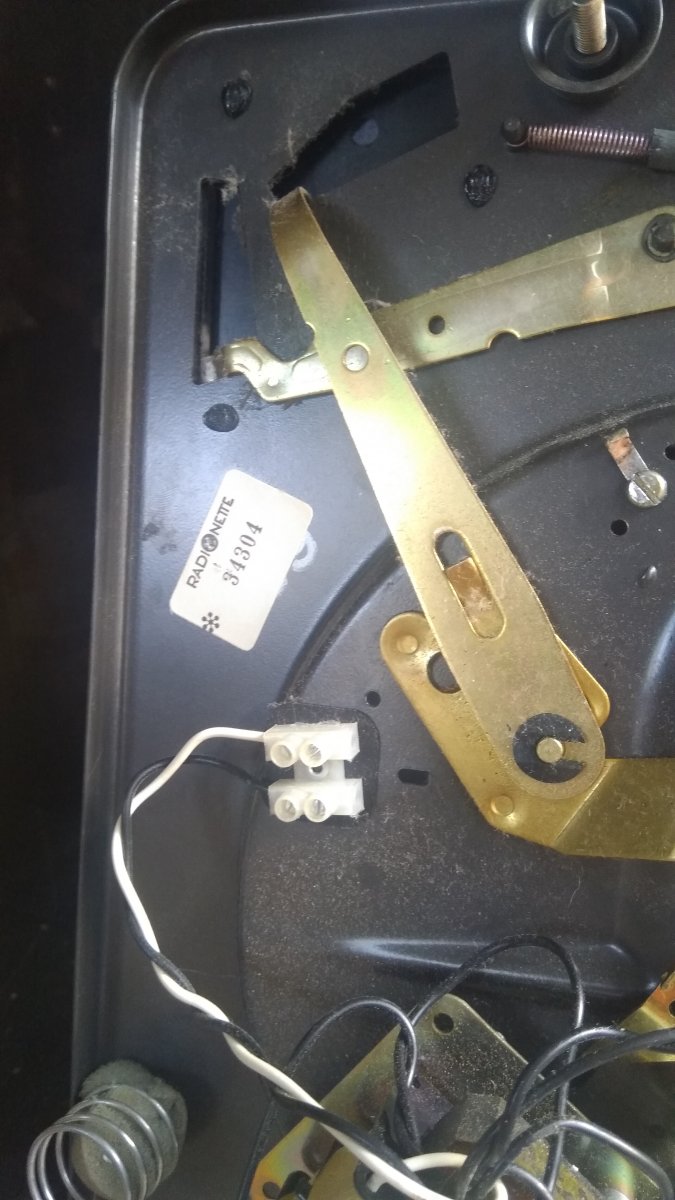

    Noen som har vært borti Radionette RIAA?
    Fant denne inni en Garrard SP 25 mk II.
    Er forbikoblet. Er det trygt å sette strøm på?
    Hadde vært artig å prøve.

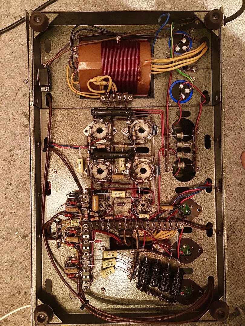

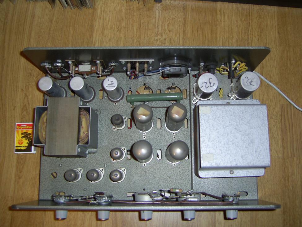

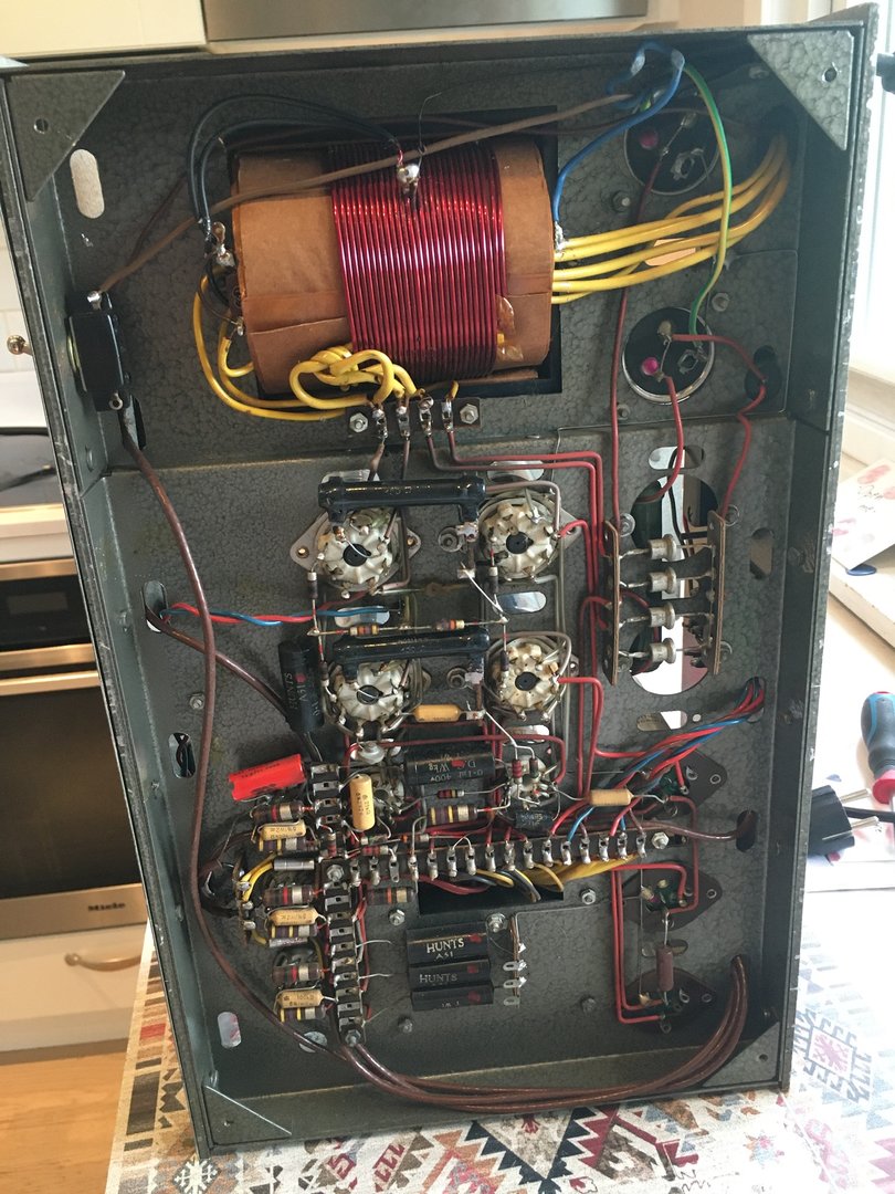

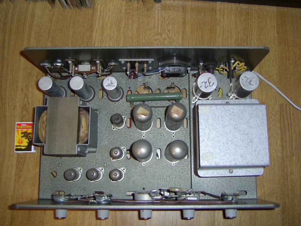

    I put mine away many years ago because the output broke down. I think it was EL34.
    jarlerik
    geirendre
    27.12.2017
    740
    1.205
    Bodø

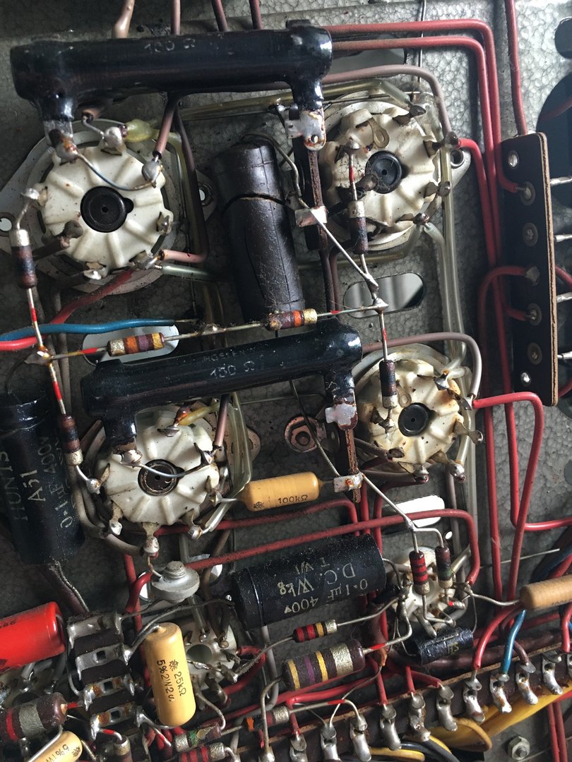

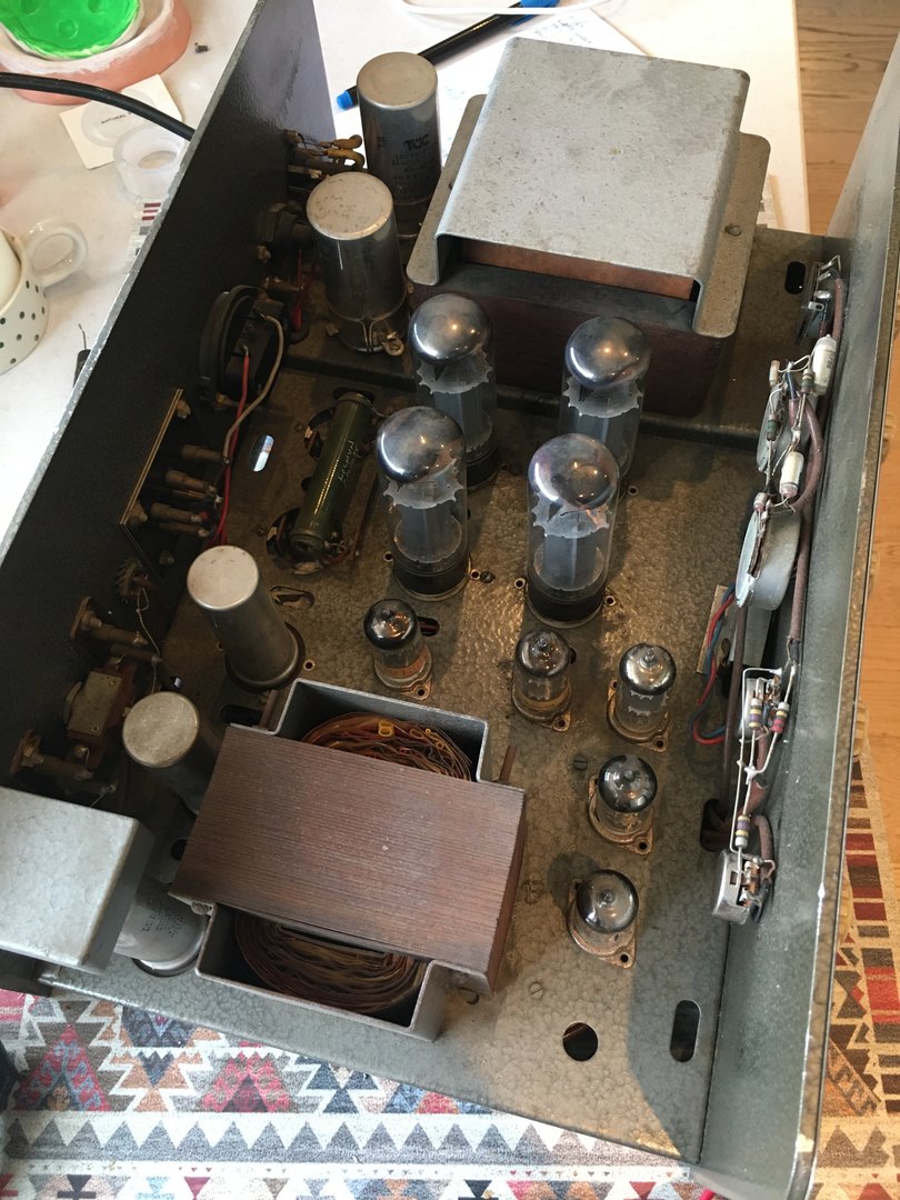

    but two EL34 are red plating
    Have you measured the grid voltages on those tubes?
    From the pictures it looks like you stil got the original Hunts paper capacitors connected.
    If they are, you should replace them with new film caps.
    Those could well be the cause.
    Marcomel
    01.07.2023
    Nesoddtangen
    That picture was taken before i replaced 95% of the components. The problem turned out to be the cathode resistors, as their value was too low. At 160ohm i had 25V drop, for 78mA current per tube, with 428V on the plates, for 33W dissipation!!!
    I bumped them up to 220ohm and im now at a bit above 24W dissipation.
    I did use a light bulb limiter for the initial start up.
    This is the picture of the amp after i changed most components, but before i changed the cathode resistors.

    Yeah, it sounded strange that you should have changed 95% of the components,
    and still have those old Hunts caps in there 😋
    Glad you got it working, it looks great now.
    Excellent work. 👍
    Excellent work. 👍
    Those Hunts caps are notorious for drifting, but amazingly they tested qt less than 5% drift. I bin them anyway....

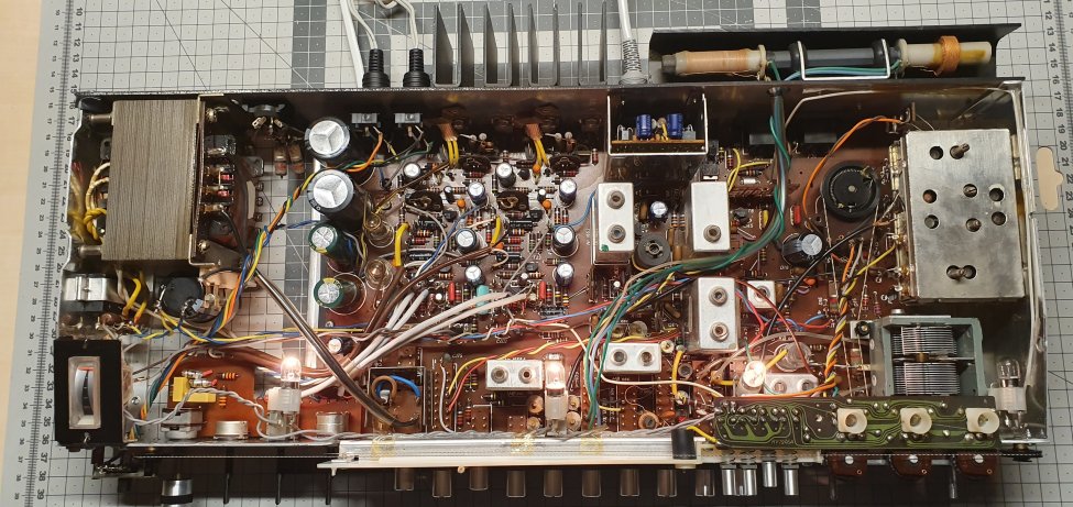

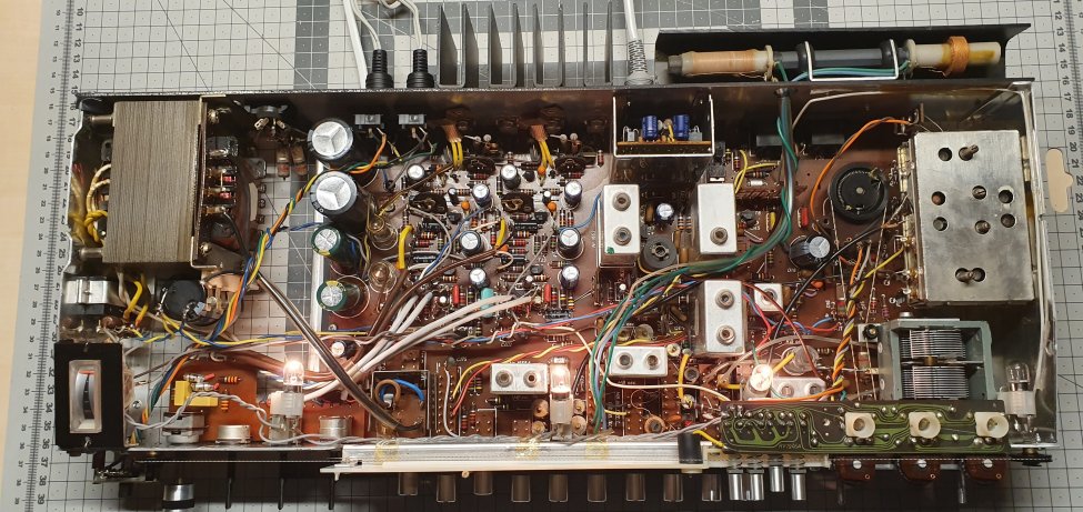

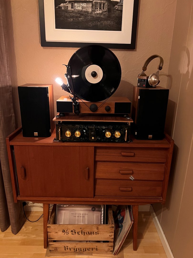

    Etter en real overhaling med nye kondensatorer, skalapærer, sikringer og noen nye dioder,
    en real rengjøring innvendig og utvendig samt rens og smøring av brytere og potmeter,
    (hadde også ute AM-søkeren og renset den for størknet grease, og smurte den opp igjen)
    så ble Soundmasteren litt lengre oppe her som ny jo :)
    Vis vedlegget 561110
    Vis vedlegget 561111
    Har nå fått seg nytt hjem på andre siden av landet, der den nok vil skape god-lyd og glede i mange år fremover.

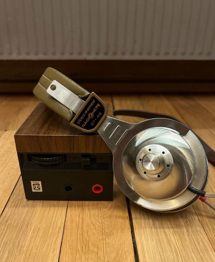

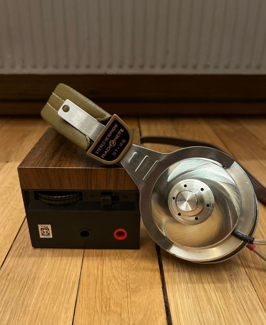

    Hei,

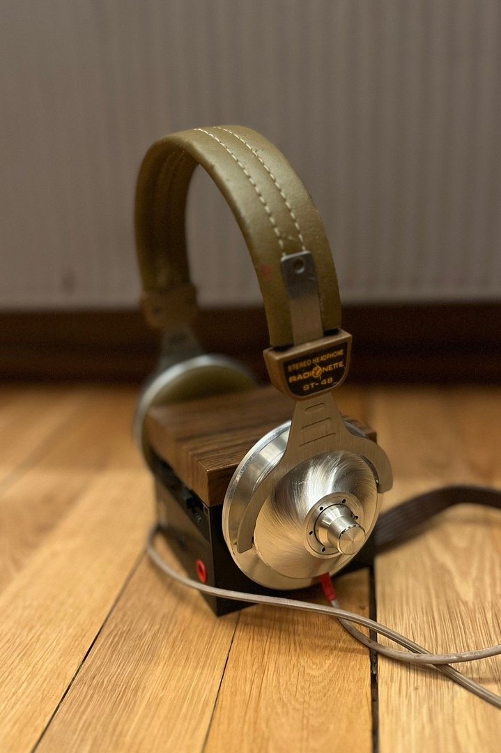

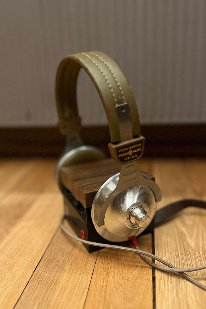

    Jeg har kjøpt noen vintage-hodetelefoner av typen Radionette ST-48. Har gjort flere søk, men klarer ikke finne noe informasjon om når de ble produsert, hvilke element som er benyttet og generelt alt annet.
    Håper å høre fra noen av dere

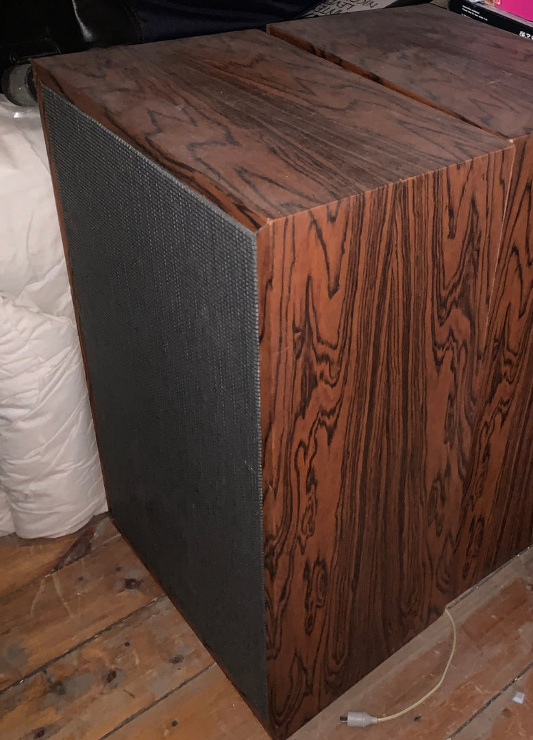

    Et par pene høyttalere uten noe merking bortsett fra Radionette-emblemet på fronten og egentlig de kjente små skruene til terminering bak. Har ikke tatt ut elementene og kikket bak men dette ser umiskjennelig ut som SEAS. Noen som vet noe om Radionettes typebetegnelse på disse?

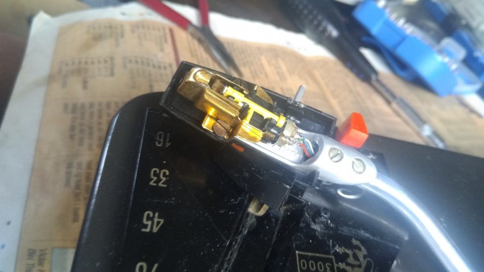

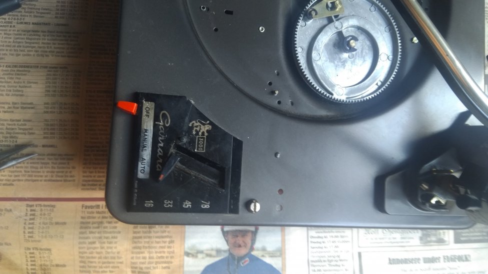

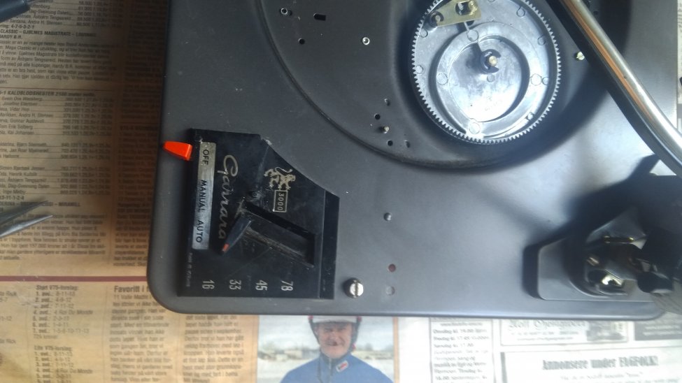

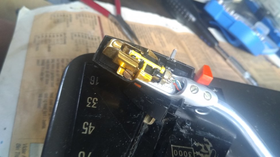

    Dette er tydeligvis en Garrard 3000, liten tvil om det når en ser på nederste bildet. På plinten finns ingen logo eller andre merker enn Garrards merkelapp med serienummer på. Så å finne et serienummer fra Radionette når jeg åpna den --- det overraska meg en smule, ja. Til tross for at jeg vet Radionette aldri laget platespillere. Noen som vet noe om dette? Hvis de rebrandet burde jo Radionettes logo vært synlig utenpå, for reklamens skyld mener jeg. Plinten ligner generell Garrard og serienummeret utenpå er klassisk Garrard. Heller ingen antydning til rester/merker etter noe logo som har falt av heller.
    Som dere ser har den Sonotone 9TA montert. Om denne PU'n virker vet jeg ikke da jeg mangler stift, signalkabel og må gå igjennom mekanikken og opphenget av armen først.
    Er det noen her inne som har tips til hvor stift, pick-up, arm-støtte og stiftbørste kan finnes?

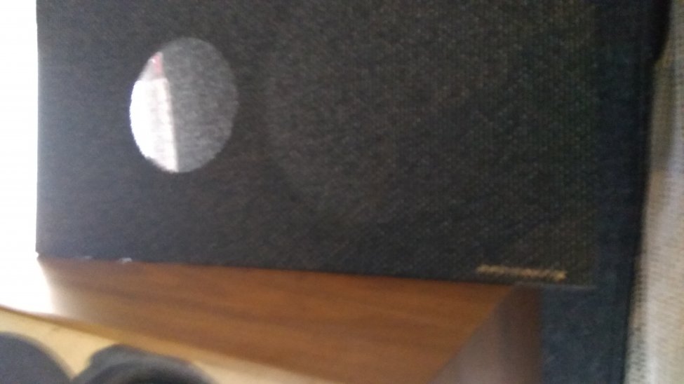

    Angående de høyttalerne, så er det litt vanskelig å se størrelsen ut fra bildene. Men er det 21cm basser i dem så er det enten TK-18S eller TK-20S. Er det 17cm basser så er det TK12S. Seas elementer, fordi eier og grunnlegger av Radionette Jan Wessel også eide 50% av Seas. Angående den Garrarden: Radionette var norsk importør av Garrard d.v.s. at platespillerne komplett eller i deler på en eller annen måte var innom Radionette. Nummereringen ser ut som et serienummer, sikkert noe de satte på for å holde styr på batch og garanti etc.

    Har også et sett med slike øretelefoner. Og kan ikke finne noe om dem hverken på nttet eller i brosjyrer som jeg har mange av. Ref historiene til Hildisch her i forumet og også andre steder, de kjøpte jo mye forskjellig fra Japan bl.a. platespillere, flere typer av mikrofoner (som jeg har brosjyre på) og også kassettradioer, kassettdeck og kassettspillere for innbygging, noe av dette fra JVC. Så tipper de er fra midt på 70-tallet og japanske, med norsk logo.

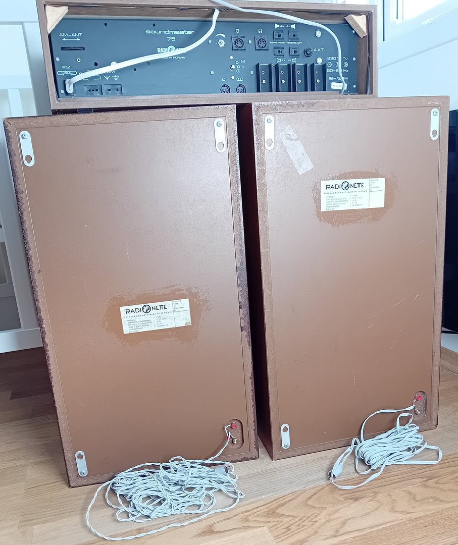

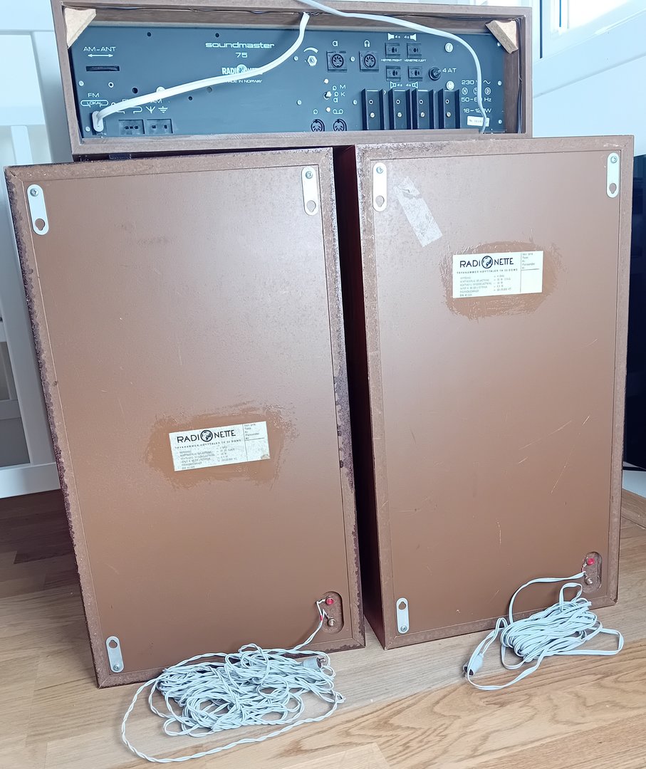

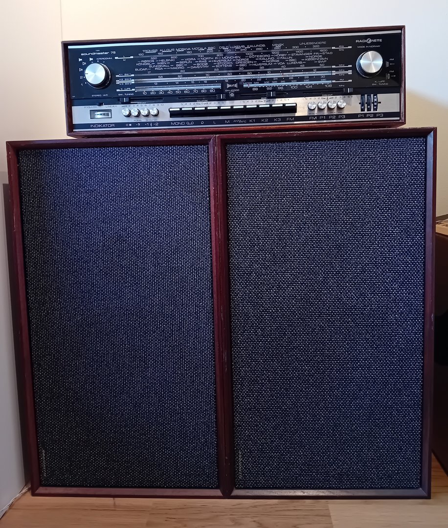

    Jeg vurderer å selge min Soundmaster 75 og to TK 35 Dome høytalere, men vet ikke hva de er verdt. Jeg håper på å nytte deres ekspertise i dette forumet :) Det er bare orginale deler og de har aldri blitt reparert. Har også den originale Soundmaster 75 brosjyren som fulgte med da faren min kjøpte dette på 70-tallet. Se vedlagte bilder.
    Kan noen gi meg en pekepinn på hva dette er verdt? :)

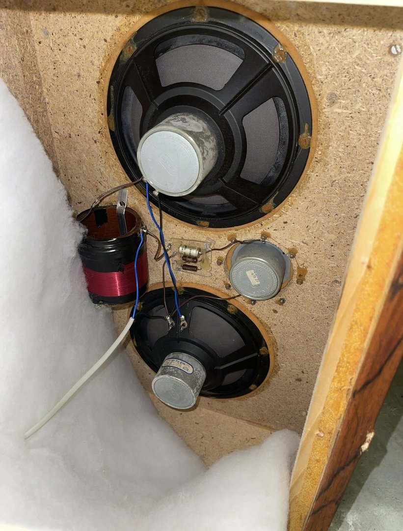

    Hei Mare, jeg har akkurat begynt å pusse opp min Radionette TK35 Dome, har dessverre ikke noe datablad fast på baksiden av høyttaleren, kan du ta et klart bilde av klistremerket på baksiden av høyttaleren slik at jeg kan printe det ut og klistre den. Beklager kvaliteten på innlegget, jeg snakker ikke norsk, hilsen fra Polen.
    HI-FI ART
    Fersking
    08.10.2024
    POLAND
    Jeg vil være takknemlig for all informasjon om denne serien med høyttalere, det er veldig lite på Internett, praktisk talt ingen informasjon om Radionette TK35 dome diskanthøyttaler, jeg oppdaget dette selskapet nylig, de lager vakre ting, jeg tror dette er begynnelsen på dette bekjent.
    Vis vedlegget 1062511 Vis vedlegget 1062512 Vis vedlegget 1062513
    Heisan. Vanskelig å angi pris. Spesielt når det ikke har vært på service de siste årene. Uansett er det nok interesse og du kan jo be om bud. Hvor bor du?
    Kunne du tatt målene av høyttalerne? Jeg har noen som ligner, men det er ingen merking på de.

    Halla. Selvfølgelig kan du få bilde av merket :)

    Hei. Jeg bor i Oslo, Oppsal. Mål på høyttalerne er H: 60cm, B: 33,5cm, D: 26,5cm.
    Heartbreaker
    Fersking
    16.04.2023
    1470
    Takk for info.

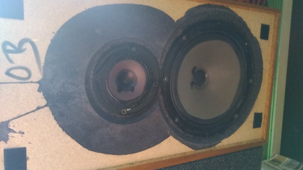

    Tror mine er hjemmelagde siden det ikke er noen merker og delefilter ser ikke så proft ut.
    Målene på mine høyttalere er H: 62cm, B: 39cm, D: 25cm.
    Elementene er 2 stk. 21 TV EW og trolig en 87H.
    Kanskje er den basert på TK 50 Dome?
    Skjønner ikke helt utregningene på volumet.
    TK 35 Dome er 35 liter, men utvendig målene dine tilsvarer 53l. Selv med fratrekk i materialtykkelse kommer man ikke ned i 35 liter?

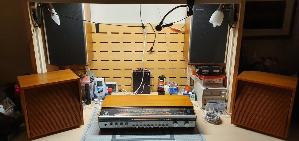

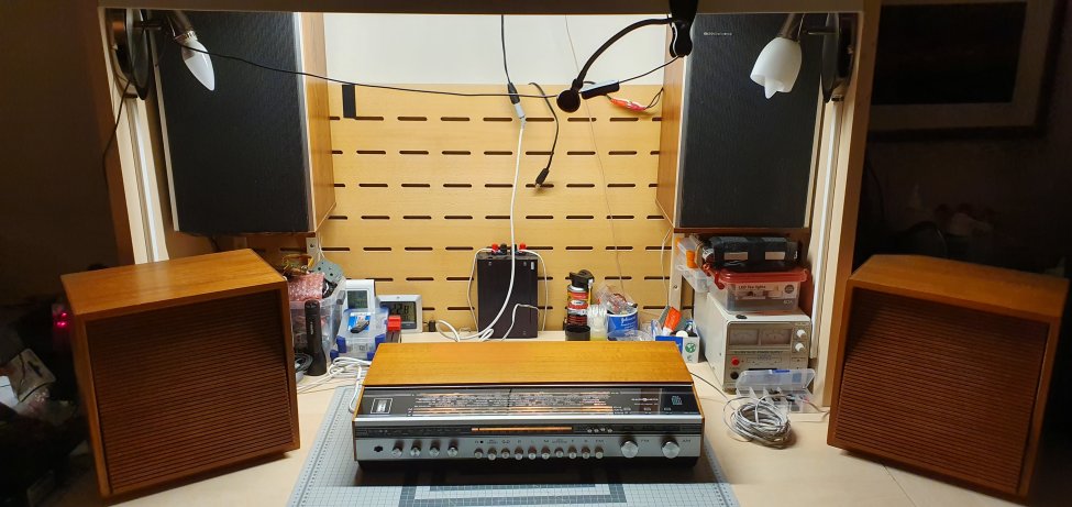

    Jeg har skrevet om det gamle anlegget i tråden for en ukjent Philips Hifi International høyttaler.
    Jeg prøver diverse høyttalere på anlegget.
    Før var det Radionette TK 12 S.
    De er nydelige på diskant - mellomtone.
    I dag er det Radionette TK 400.
    Fortsatt sammen med Philips AH 481.
    Går det bra å bytte ut Philips med TK 600?
    Forsterkeren er Tandberg TA 300.
