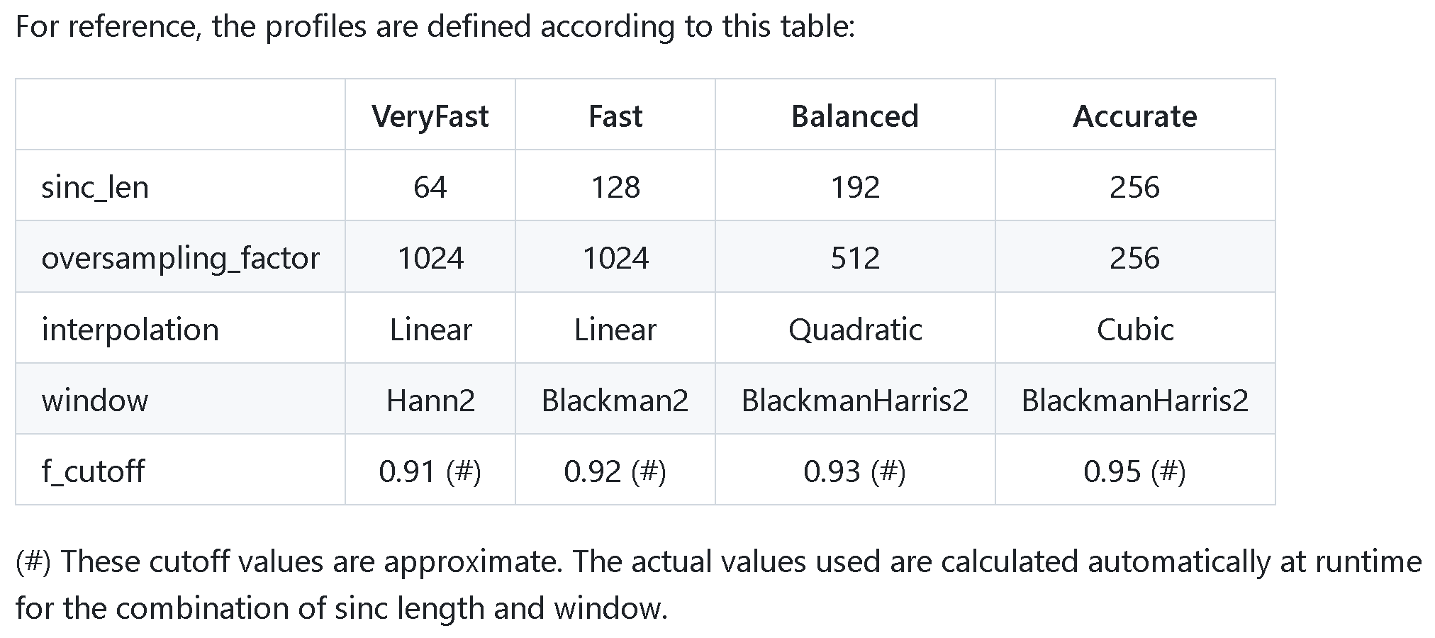

Siden CaimillaDSP ble delaktig i tråden har manualen noen fine avsnitt som tar for seg algoritmene for resampling og dither.
AsyncSinc: Asynchronous resampling with anti-aliasing
For asynchronous resampling with anti-aliasing, the overall strategy is to use a sinc interpolation filter with a fixed oversampling factor, and then use polynomial interpolation to get values for arbitrary times between those fixed points.
The AsyncSinc resampler takes an additional parameter profile. This is used to select a pre-defined profile. The Balanced profile is the best choice in most cases. It provides good resampling quality with a noise threshold in the range of -170 dB along with reasonable CPU usage. As -170 dB is way beyond the resolution limit of even the best commercial DACs, this preset is thus sufficient for all audio use. The Fast and VeryFast profiles are faster but have a little more high-frequency roll-off and give a bit higher resampling artefacts. The Accurate profile provides the highest quality result, with all resampling artefacts below -200dB, at the expense of higher CPU usage.
kilde: https://github.com/HEnquist/camilladsp/tree/next20#resampling
Der er også et kapittel om dither som man normalt behøver i en DSP prosess. Nå skriver han at dette er ment for 16-bit. Men jeg har forstått fra andre kilder at man anbefaler dither brukt også på 24-bit avkorting - https://github.com/HEnquist/camilladsp/tree/next20#dither
