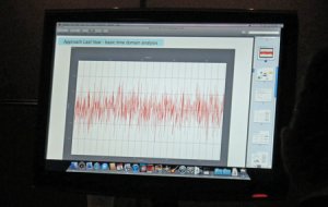

Last year, Roy Gregory of Nordost and Steve Elford of Vertex AQ (pictured, with Elford on the right) projected a series of difference graphs that demonstrated the effects of audiophile power cables, supports, and Nordost's Quantum device on sound. Simply changing from a stock power cord to a well-made audiophile cord resulted in a 36% reduction in the time-domain difference between the original WAV file and the same file burned on to a CD and played back by a typical high-quality player. Vertex AQ's support platform further reduced the error by 15%.

One of the many graphs Nordost and Vertex displayed at their research presentation was of time-domain error in a CD player, ie, the difference between the data on a disc and the output of the CD player. It ain't pretty. Other graphs showed reduction in error with the addition of cables, supports, and power products (specifically, Nordost's Quantum). All these graphs will be downloadable from the websites of Nordost and Vertex EQ within a matter of weeks.

The percentage refers to the reduction in the peak amplitude of the difference signal that results from the cable or support or AC conditioner, etc. If I remember correctly, the difference between the original WAV file and the output of the untreated CD player was around 1% of the peak signal amplitude. Adding the audiophile voodoo reduced this on a consistent basis by 36%, ie to 0.74%.

Interessant. Det ser ut som om målingen påviser feil i tidsdomenet, hvor en liten feiltiming av en transient kan føre til en ganske stor spike på disse kurvene ettersom differansen i amplitude kan bli ganske stor selv med en liten feil i tidspunkt. Forstår ikke helt hvordan kurvene synkroniseres i forhold til hverandre når målingen skjer, og funderer på hvordan dette passer sammen med fase og group delay, men interessant likevel. Det kan jo virke som om øre/hjerne legger mer vekt på hvordan ting skjer i tidsdomenet i starten på en transient.

Det er i grunn ikke så små avvik i tidsdomenet vi snakker om. Høyt oppe i frekvens er avvikene nesten 2 ganger større enn bølgelengden på den ene spilleren om jeg ikke tolker presentasjonen feil. Korrigert for group delay ser man at avvikene såvisst ikke opptrer jevnt i forhold til frekvens.
Forbedringen ved bytte av strømkabel er formidabel og forbedrer avviket til bare 1. bølgelengde.
