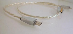

    The USB [Universal Serial Bus] spec defines the Mechanical, Electrical and Protocol layers of the interface. Cables and connectors are fully defined. USB defines 2 types of hardware, Hubs and Functions. Up to 127 devices may be connected together in a tiered Star topology [Bus Topologies]. The limiting factor being 7 address bits. The physical wire segments are point-to-point between a Host, Hub, or Function. The system may only have one Host, which connects to a Hub. A USB Hub may connect to another Hub or to a USB Function. Each layer transition from Hub to Hub represents another Tier. USB Hubs allow connection to a USB bus, while USB Functions are the devices which perform some function.
    The USB bus is a [Differential] Bi-directional serial interface cable bus. Differential NRZI data is transmitted Isochronous or Asynchronous between devices. Data is transferred at three different rates over a maximum cable length of 4 meters ~ over 4 wires, 2 of which carry data on a balanced twisted pair.
    USB may operate at any speed from 10kbps to 400Mbps in one of three speed modes. A Slow-Speed mode of 10kbps to 100kbps is used for devices such as a USB keyboard or USB mouse. Full-Speed mode is used by most devices and allows a transfer rate of 500kbps to 10Mbps. High-Speed mode [defined by USB 2.0] allows rates of up to 480Mbps, with a speed range of 25Mbps to 400Mbps. Transmission at the High-Speed mode requires the addition of 45 ohm termination resistors between each data line and ground. Operation at Full-Speed mode is 2.8 volts [High] to 0.3 volts [Low]. Operation at High-Speed mode is at 400mV +/-10% [High] to 0V +/- 10mV {Low]. Cable impedance for both modes is 90 ohms +/- 15% (differential).
    endrea
    09.06.2003
    1.700
    139
    Klippet fra AQVOX sine hjemmesider. Det kan virke som tyske AQVOX er av den oppfattning at det er viktig at USB kabelen har en impedans på 90 ohm?
    audiophile USB cables from AQVOX - the inventor of audio USB-cables
    The AQVOX audiophile USB cable is for sure one of the best, if not THE best USB cable on the market.
    AQVOX was the first company who started the development of dedicated highend USB cables many years ago, we know how to do it right.
    Aqvox was 2006 the first manufacturer, who developed USB-cables specially for the audiosector. Since 2006 we do offer audiophile USB cabels, which are technically and acoustically optimized that every user can instantly hear the improvenment.
    Why is there any sound degradation ? it all depends on signal quality. In USB-audio the computer sends the data to the USB-DAC in datapackets.
    If the DAC receives error/missing packets there is only a very small timeframe during what the DAC can tell the computer to re-send the packets.
    If this timeframe is passed, the music is played without these packets and this degrades the soundquality. USB-Audio transfer is a completely different thing as USB-data transfer.
    Ferrite
    Ferrite rings/beads have to be avoided, as they affecting the highs. Because they filter in same frequency bandwith as the transmitted USB-audio datastream.
    USB signal quality
    Digital Audio signal cables for USB. Just because it is a USB-signal, it is not automatically resistant against signal-alteration due to different influences! The trivial argument: that is digital, so 0 or 1, yes or no, there can nothing be wrong, is a statement in general only made by users who have no own experience in developing digital- or data-technology.
    The development of best USB-cables requires appropriate measuring equipment, where signal-problems can be detected and on construction level and proper material selection nearly be eliminated.
    Even here: the ear is also a development tool.
    USB Signal Measurements
    If we find the time, we will publish here some screenshots and measurement protocols of USB-signals. Professional USB-developers will explain the results in an understandable manner. We will compare and analyse standard USB-cables with AQVOX USB-cables.
    To be honest: for our experience, the audible differences between USB cables can be huge when it comes to audiophile standards. The AQVOX USB cable sounds very open, transprent and natural, without any harshness. Our customers can go sure, that the AQVOX highend USB cable is made of the very best materials, provides maximum soundquality. A good hifi set will reveal the advantages of a good USB connection. The sound improves over the complete frequency bandwidth and in all aspects.
    Just try it !
    Design
    Not to forget the mechanical strength, craftsmanship build quality and the attractive professional design.
    Product-Details
    90-ohms Impedance corrected and audio optimized audiophile High End USB cable.
    Massive full metall USB plugs, 24k gold plated contacts, silver solder joints, double shielding is optimized for low inductivity and capacity.
    No ferrite-elements. Specially Gas-filled conductor insulation, this has far better damping values as the mostly used cheap PVC insulation
    and keeps the signal quality in better shape.
