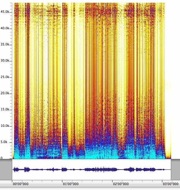

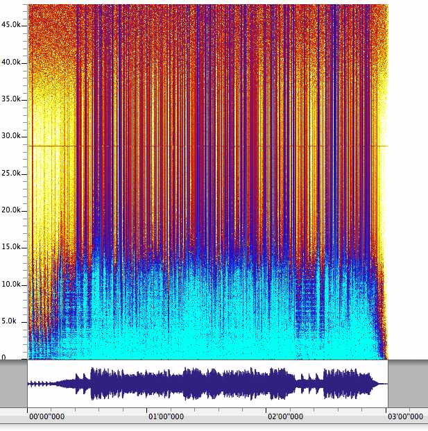

    I augustnummeret av HiFi News tar redaktør Keith Howard opp emnet igjen, med bruksanvisning til dem som ønsker å sjekke filer de laster ned.
    På iTrax har Waldrep gjort en analyse av Redbook Route 66 av Rolling Stones, som selges som 24/88.2:
    http://itrax.com/Pages/ArticleDetails.php?aID=31&x=10&y=12
    Waldrep innleder slik:
    It continues to be a source of personal frustration and annoyance that music fans and audiophiles continue to be misinformed about the audio fidelity of various music releases through digital downloads or physical sound file delivery (DVD-Rs with 176.4 or 192 kHz - 24-bit files). "So-called" standard definition, analog master tracks have been elevated to the status of High Definition or High Resolution by various companies for the past few years…starting with the now extinct MusicGiants.com (AKA HDGiants.com), who's marketing tag was "HD Music Downloads". Unfortunately, almost nothing in their catalog was in fact High Definition. They featured a multitude of recordings taken straight from CDs and second-generation analog masters (safety copies) licensed from the major labels. Their claim was that their downloadable files were "higher resolution" than the same tracks on iTunes or other digital music download sites so somehow they qualified as "HD". This was at best wishful thinking and at worse outright fraud. Thankfully, customers were unimpressed with the charade and the company went down in flames. The sad part is potential customers seeking recordings with better fidelity were left confused and disappointed.
    (EDIT - fjernet link til en billedfil, da linken på opprinnelig nettsted er feil).
    40.713
    44.462
    Det fuskes i begge dimensjoner. En ting er sample rate, altså at diskantgjengivelsen bråstopper rett over 20 kHz på en "96 kHz hirez"-fil, men bitdybden er fortsatt offer for loudness war. Det er ikke så veldig mye poeng i å gi ut en 24-bits versjon med 140 dB teoretisk tilgjengelig dynamikk når plateselskapene fortsatt insisterer på å klemme inn all lyden i de øverste 7-8 bits'ene. Jeg har opptil flere "24-bits" opptak fra Naim og Linn som er like knallhardt komprimert som CD-utgivelsen. Eksempelvis 13 dB crest factor...

    Hiver meg på her - har nettopp hændla litt hos Hdtracks.
    Det jeg finner ut, er at det stort sett er greit - jeg mener at det låter hakket bedre
    enn CD - selv om jeg ikke har A/B-testet mot CD-utgivelser av samme plate til
    røyken står ut av øra.
    Her er det jeg fant når jeg gikk litt mer vitenskapelig til verks:
    Eagles - Hotel California (24/192):
    Talking Heads - Born Under Punches (24/96):
    The Who - Pinball Wizard (24/96):
    Synes dette ser helt greit ut - det er frekvenskomponenter til over 25 kHz i alle tre tilfellene - her må jeg
    ta LITT forbehold, siden jeg er usikker på hva disse "massive strekene" som Amadeus Pro tegner opp er - inneholder
    virkelig filene "en jevn dose" med samtlige frekvenser opp mot samplingsgrensen, eller er dette en "artifakt" av format
    eller program?
    Som sammenligning har jeg et par opptak gjort på min M-Audio FireWire Audiophile fra to DVD-Audio.
    Den ene inneholder frekvenser helt opp til over 40 KHz, mens den andre ser ut til å stoppe tvert ved 22 KHz.

    Det siste eksempelet er uten tvil en indikasjon på gjenbruk av en "simpel Redbook-master" - tør man gjette på
    at det er komponenter opp til eksakt 22050 Hz?

    Tja - ingen skal vel forvente at det er flusst med frekvenser opp mot 30-40 KHz på gamle innspillinger?
    Hovedgevinsten er nok uansett gjengivelsen av frekvensområdet under 20-25 kHz, ved å flytte samplingsgrensen
    til 96 eller 192 kHz.
