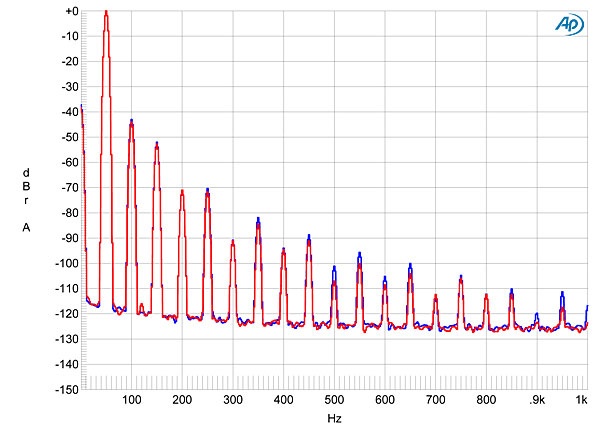

    Tja, referanse og referanse...
    Things didn't look so good, however, when I performed a wider-band spectral analysis with the PS Audio processing dithered data representing a 1kHz tone at –90dBFS with 16-bit (fig.6, cyan and magenta traces) and 24-bit data (blue, red). With 16-bit data, the noise floor is dominated by the dither used to encode the signal, though a trace of second-harmonic distortion is visible. But when the bit depth was increased to 24, which was correctly indicated on the front-panel display, the noise floor dropped at most by 5dB, suggesting that the DirectStream DAC has only about 17 bits of resolution. This graph was taken with AES/EBU data; I got the same result with USB data, and though fig.6 suggests that the PS Audio DAC should just be able to resolve a 24-bit tone at –120dBFS, spectral analysis showed that it couldn't (figs.7 and 8 ). Its higher-than-expected noise floor meant that the PS Audio couldn't correctly resolve the waveform of an undithered 16-bit tone at exactly –90.31dBFS (fig.9). (For superb behavior on this test, see fig.6 in the review of the Antelope Zodiac Platinum elsewhere in this issue.)
    In many ways, PS Audio's DirectStream DAC measures superbly well. But I was somewhat bothered by its ultimate lack of resolution with data capable of higher-than-CD resolution, which I suspect lay behind AD's finding the processor to sound "a bit rounded off" and lacking in immediacy. Whether or not that will be an issue will depend on the listener's taste and the character of his or her other components. It is also fair to point out that the DirectStream's introduction of random noise at the 17-bit level will be sonically preferable to a processor whose errors consisted of enharmonic tones. But I was bothered by the PS Audio's poor linearity at low frequencies. Yes, some extra second- and third-harmonic content at low frequencies will add some "phatness" to the sounds of bass instruments; and as the nonlinear transfer function has been significantly improved in the midrange and above, that "phat" quality will not be accompanied by the high-frequency harshness of intermodulation. But the engineer in me doesn't like to see it.—John Atkinson
    Spektrum av en 50 Hz tone ved 0 dBFS:
    PS Audio PerfectWave DirectStream D/A processor Measurements | Stereophile.com
    Forvrengningskomponenter ved -40 dB er 1 % forvrengning bare der. Det er vanligvis en slags skillelinje for hvor mye forvrengning som kan tolereres i en høyttaler. Og det skulle liksom være "et fåtall sub-optimale målinger som ikke degraderer lydkvaliteten"? Subwooferne mine forvrenger mindre enn det der. :rolleyes:
    Disse målingene ser forresten ut til å være helt konsistente med de hos HiFi News.

    Han skriver det om avvikene i frekvensgang, for eksempel det merkelige lille løftet øverst i diskanten. Jeg vil ikke utelukke at det kan være hørbart, men la gå.
    Har du eksempler på innspillinger som har utstyring til over -1dB i frekvensområdet over 10kHz ?
    40.734
    44.534
    Nei, jeg har ikke det, men når vi har diskutert kabler har ihvertfall jeg ansett avvik på +/- 0,1 dB potensielt hørbare. Du har rett i at denne neppe vil bli trigget av noen normal innspilling. Forvrengningen i bassen vil derimot bli trigget av hvert eneste slag på en basstromme/stortromme.

    Som sagt så er ting blitt korrigert, men endringene er ikke hørbare.
    Nå må du slutte å vri det selv. En liten flik er korrigert, noe lsb-greier. Hadde alt vært korrigert slik at målingene hadde fremstått slik man muligens forventer utifra pris/hype/whatever, så kan du banne på at det hadde vært hørbart.
    Hypen var at den lyder best, ikke måler best, altså oppnådd.
    Vi får se når de nye målingene kommer, men de bekymrer uansett ikke meg. Jeg hører hva jeg hører.

    Har du lest noen av de andre testene, Asbjørn - eller leter du bare frem det som måtte understøtte målinger?
    Det er jo stort sett 'rave' over hele linja.
    Som du sier, jeg (og ganske mange med meg) får bruke tiden på å høre på farget lyd, så får du kikke på kurver - ville ikke byttet ;)
    Jeg har lest en del av de andre testene også, men livet er for kort og lommeboken for liten til å prøve alt overpriset og oppskrytt ræl som finnes der ute. Målingene i Stereophile og HiFi News er en grei grovsortering av hva som kan være verdt å prøve. Denne er det ikke. Og det var etter at jeg begynte å forstå litt av sammenhengen mellom målinger og subjektiv lydkvalitet at jeg begynte å få skikk på lydkvaliteten hjemme hos meg, så jeg ville nok ikke byttet, jeg heller. :)
