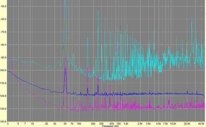

<<The unloaded battery noise is the pink plot. It is indeed 10dB lower than the blue trace, which was made off a discrete low-noise regulator. However, increasing load current to 35 mA yields the light blue trace for the battery: at least 20dB worse than the regulator! >>

Spennende Cobra!
Jeg regner med at "peaken" på støyspekteret til den regulerte skyldes nettfrekvensen på 50 Hz...men hvorfor har batteriforsyningen en peak på 50 Hz...?

Antakelig innstrålt støy? Har ikke lest alt ennå...
CT102 vs batteries
As far as noise is concerned there is no question that nothing beats batteries. We have not been able to measure any self-noise from batteries at all, but CT102 comes very close at a so far unseen measured noise figure of -126dB (IHF A).
Ellers er jo ikke akkurat 8 seriekoblede D batterier en relevant sammenligning i denne sammenhengen.
