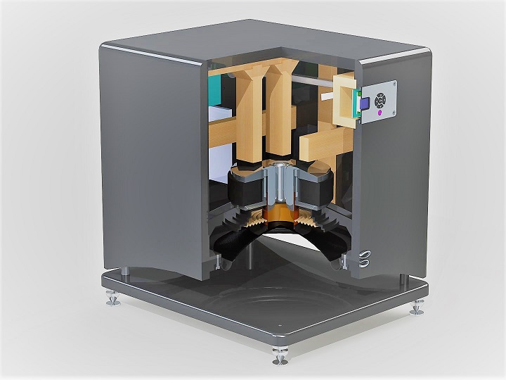

    Jeg lar nå dypabssen gjengis av to DSP subwoofere og jeg hører mye mer musikk.
    Sider ved musikken dukker frem som ellers er helt filtrert bort av kompromissene i en passiv konstruksjon. Det er også andre fordeler.
    Subbene er et veldig rent DSP design, 500W klasse D forsterker, høy kvalitet og trykkammer, helt i henhold retningslinjene i Pat McGinty artikkel vedrørende dypbassdelen i en DSP konstruksjon uten passive komponenter.https://6moons.com/industry_articles/dsp-crossovers/

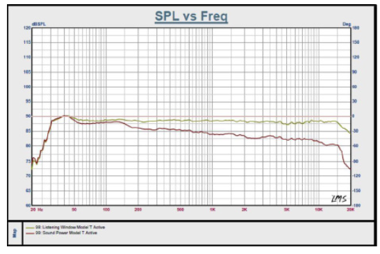

    Sitater fra Pat McGinty’s «white paper»:
    Pat's solid reasons why DSP crossovers are the future of better loudspeaker design.
    First, let me get this out of the way: passive filters suck. I know. I designed with them for decades.
    Old enough to remember the death of disco? I predict that's how quickly conventional audio (passive crossovers) is about to unravel once the consumer realizes how much more value he gets with the next generation of tech (DSP crossovers).
    One of the trickiest engineering problems we face in conventional speaker design is bass system alignment. The closed box is simplest but fails to deliver as much bottom end as a vented alignment.
    That trade-off is now gone. We can very simply and straightforwardly make a closed box that does nothing more than optimize the woofer’s rise and settle times as the measure of how well output tracks input. Of course just as with closed boxes of the past, the low bass goes away. But now we can simply dial it back in. Now we get superior bass fidelity and extension in a much smaller box simply by applying power and manipulating the signal. You do need a woofer that can take the punishment—read: a more expensive driver—but since we can cut the box size in half or better, I'll happily call that a wash. Maybe it takes a 400 watter on the woofer but who cares? Audiophiles don't know it yet but first-rate amp power is actually pretty cheap. At Meadowlark we have a saying: "Power is cheap. Use lots!".

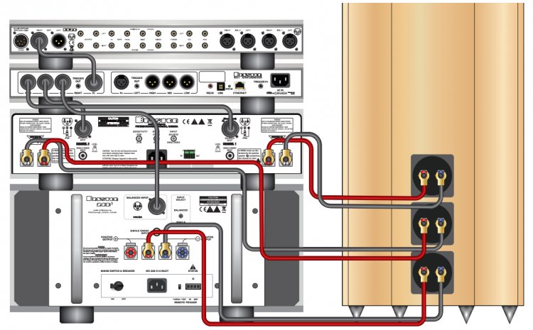

    For egen regning:
    Passivt delefilter med spoler, motstander og kondensatorer er gammel "steampunk" teknologi.
    Nå har vi fått noe mye bedre

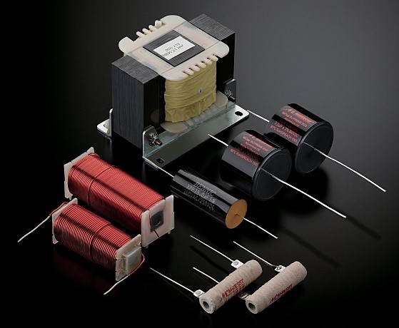

    Delefilter-komponenter i Yamaha NS-5000
    Den store spolen veier 1,5 kg
    Dette er altså høyttalerne jeg bruker. 8 komponenter må være ganske optimalisert for et 3-veis sysyem???
    Vel, bassen er ikke optimal nok :p

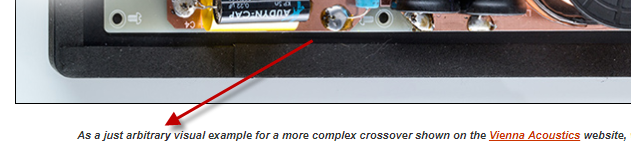

    Det passive filter der linkes til er fejlkonstrueret. Fysisk opbygning er crap og alle serie komponenter ligeså.
    Du kommenterer så langt jeg kan forstå spesifikt på noe som er brukt som et tilfeldig illustrasjonsfoto?
    "As just an arbitrary visual example..."
    Kan vanskelig se at det er noe poeng i det?
