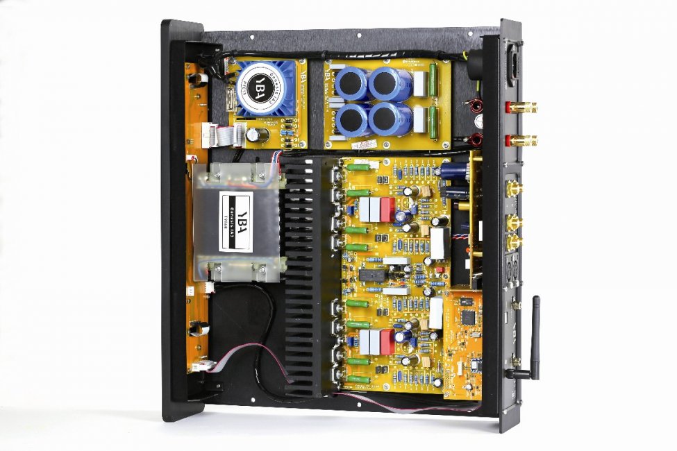

Fin fransk sak. Skal være en variant av klasse A? Finner lite info om dette, så legger ved et bilde av innside.
Noen som vet?

Yves Bernard André – the Founder and Designer:
YBA diagrams are the elegance of simplicity.
They consist of a differential input of a current source transistor, two complementary transistors in each of the two stages of voltage gain A class, followed by output transistors (2 to 6), for a total of 8 to 12 transistors per channel.
All transistors used are selected for their auditory qualities. The difference is evident due to the selection of low noise transistors. The drivers have a very wide bandwidth (40 Mhz) and the output transistors are high current (30 amps).

Ble ikke klok på teknologien, litt uklart fortsatt, men som vi tenkte da.
