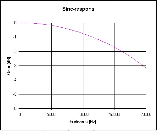

I dette tilfellet fant jeg noe Bruno Putzeys (Hypex) skrev et sted, riktignok bare som sitat andre steder, ikke originalteksten:
Regarding NOS: such converters have a frequency response of sin(pi*f/fs)/(pi*f/fs). This causes its characteristic sound. A friend of mine who is a mastering engineer once came raving about some box by Altmann. So I told him to upsample his audio 2x, then mix it with itself shifted 1 sample, take it back down 2x and listen what it does on a real DAC. The result was as predicted. This signal through his normal DAC sounded exactly like the original signal through the Altmann. Theory wins, again.
Den sinc-formelen gir en frekvensrespons som ser slik ut:
En innebygget eq med -1 dB ved 11 kHz og -3 dB ved 19,5 kHz, ca. Jeg foretrekker også eq-profiler som heller 3-4 dB ned fra 20 Hz til 20 kHz. Kan det være så enkelt som det?

Sinc-funksjonen er fouriertransformen til en firkant, så den velkjente "trappetrinn-kurven" som mange (feilaktig) tegner digitale signaler som er en sinc-filtrering av samplesekvensen. Hvis en DAC har zero-order hold (ZOH) rekonstruksjon blir frekvensresponsen sinc(f/fs).

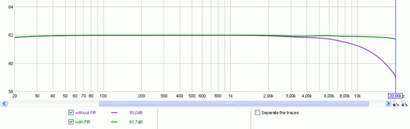

Vincent Brient hos TOTALDAC DAC and digital crossover mener tydeligvis at det er mer enn frekvensresponsen som skiller NOS-DACer fra røkla:
FIR compensation filter:
Non-oversampling DACs are known for their musicality but they all have a problem, the frequency response is not flat and the treble loss is more than 3 dB at 20KHz. This is called sinus(x)/x loss. All DACs with oversampling compensate the sin(x)/x loss in their digital filter. On the TOTALDAC board I didn't want to use oversampling because I prefer non-oversampling DAC sound, but I used a FIR filter to compensate the sin(x)/x loss. It is a short FIR for high frequencies only, so response before impact is short and is not a problem.
Frequency response at 48KHz with and without FIR filter, the response is flat to 20KHz when the FIR is used:
40.741
44.575
Jeg tror nok den frekvensresponsen er hovedpoenget, men det er noen forskjeller i tidsdomenet også. Ut fra hva jeg mener å vite om hvordan øret fungerer, vil jeg tro at de forskjellene i impulsrespons er mye mindre hørbare enn frekvensavvikene.
Når Brient setter et FIR-filter etter DAC'en for å kompensere frekvensavvikene har jeg ærlig talt litt vanskelig for å se poenget. Det filteret vil nødvendigvis innføre en del av de samme tingene som NOS-chipen forsøker å unngå. Han skriver at det er "not a problem", men burde muligens skrevet "why bother?"
