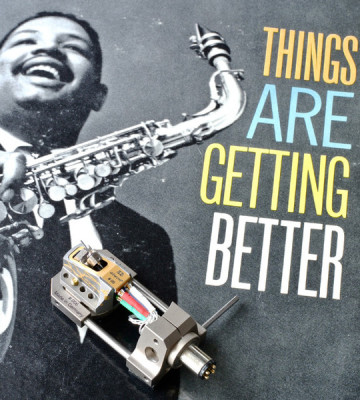

the Aiwon - Ny top of the line PU fra Acoustical Systems
Etter suksessen med the Archon kommer nå Acoustical Systems med en High End PU i det absolutte toppsjiktet - Aiwon.
Dette er en low output MC.
Pris: 68.800,-
It is with quite a proud feeling of satisfaction and excitement that we present the aiwon©
(ancient greek "the eternal principle of play").
This is our statement regarding low output moving coil phono cartridge design.
It shares the same general architecture with it's smaller brother - the archon©.
It however displays and incorporates a bundle of different improvements in most vital parts - some easy to spot, some very subtle and hidden - in micro design, material composition, individual fine-tuning and - ultimately ... - sonic performance.
The aiwon© is the best example for what improvement is still possible in phono analog front-end sonic performance.
Possible only if all parameters are carefully fine-tuned.
Fine-tuned to thus create much more than the mere sum of the parts.
The aiwon© is "old school" at its very finest.
A sonic performance second to none, - featuring a live-likeness, dynamic contrast, emotion expression and "you are there" character one has to hear to realize what was missing so far - missing in even the very best set-ups.
The aiwon© is carefully handcrafted in Bavaria.
Each aiwon© is handcrafted and carefully fine-tuned to ultimate performance by one person only.
All the perfromance of your analog set-up starts here - in the groove - with the cartridge.
Give the aiwon© a listen in your personal set-up - it will enrich your listening pleasure and musical enjoyment beyond your expectations.
The aiwon© will show you what your audio system is really capable of.
* 0.28 mV output
* high purity 5N silver coils
* ultra-rigid special dampened titanium "Timet 1100" corpus *
* static compliance 16-18 mm/N (18°C to 30°C) * 17 mN recommended tracking force *
* channel balance better 0.35 dB / at 1 kHz * channel separation better 32 dB *
* frequency response 15 Hz to 32 kHz +/- 2 dB * Q4 Shibata EVO stylus *
* internal resistance 4 Ohms * load resistance 100 Ohms *
* cantilever C37-coated tempered aluminum *
* cartridge weight only 11.5 grams *
