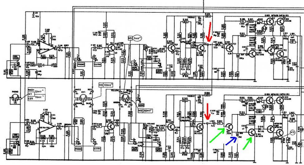

Ok, all is back, I have checked all transistors and resistors in the output stage, they are all fine, but still I get sound only in the R channel. When I turn the balance knob to the L position, I have no sound even in headphones. How do I check the pre/tone amp that you mentioned?
Red arrows: connection from preamp to power amp; it´s a single shielded wire from the preamp to the power amp. Switch them!
Green arrows: have you checked these transistors?
Blue arrow: this capacitor is in the feedback circuit; can cause malfunction if not in working order.
Thank you for your time!
I have swapped the amp cables and still I got sound from R channel only (with L amp cable connected to the R amp).
I have checked both transistors and it seemed both were dead, Q604 didn't measure on my meter at all, Q602 did, but it was cracked on one leg, so I changed both and still get sound only from R channel. The capacitor C608 is ok. Where do I go next?
