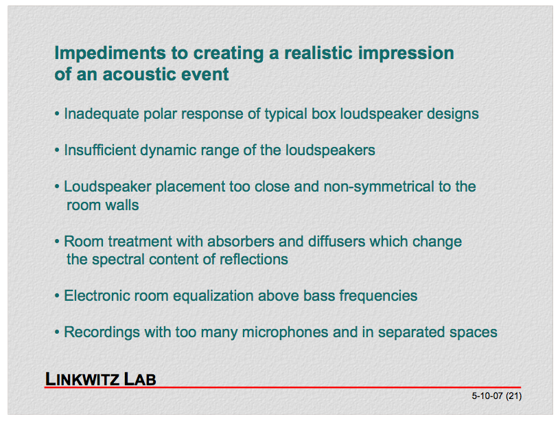

I seneste Stereophile nevnes Linkwitz, som presenterte en del tanker omkring lydreproduksjon vha en Powerpoint på Burning Amp festivalen.
Jeg tok en kikk på sidene hans, og jammen ligger ikke powerpointen der. Meget interessant.
Det varmer mitt hjerte å lese hvilken vekt han legger på romrefleksjoner!
http://www.linkwitzlab.com/Recording/phantom images.pdf
Og selvsagt har han en lengre versjon, med forelesningen i mp3!!!
http://www.aes.org/sections/uk/meetings/a0711.html
For den som ikke ønsker å lytte, er forelesningen her i kortversjon, med notater:
http://www.linkwitzlab.com/stereo reproduction.htm#Presentation

Linkwitz i Q&A seksjonen, mot slutten av mp3'en av foredraget:
Han nevner en kollega som han pleier å lytte sammen med, og som hjelper ham å forbli objektiv til det han lytter til ---
We reach independent conclusions from each other. We challenge each other, to keep each other honest.
It's so easy in sound, to imagine things. As someone has said, if I suggest something that you are going to hear, if I give you a demo, and I tell you what you are going to hear, it's almost impossible for you not to hear what I told you that you are going to hear.
It's a thing that sales people in high-end audio stores use to great effect, to sell you cables and spikes, and all sorts of stuff. It's very difficult, it's honest, people really hear things, it's happening between your ears. There is no sound in the room, there are only air particles vibrating, air particles impinging on your eardrums, that's all. And then you try to make sense of these vibrating particles. As the saying has it: if a tree falls in the forest, and no one is around to hear it, does it make any sound? No! It doesn't make any sound. Sound is just an illusion ... it is totally constructed in your head.

Men det relevante her er vel at Linkwitz og en annen kritisk og erfaren lytter bruker hverandre nettopp for å skape et skille mellom det innbilte og det faktiske ...
Før dette blir enda en kjedelig subjektivist/objektivist debatt - her er noen av Linkwitz konklusjoner. De utfordrer en del audiofiles oppfatninger av hva som er viktig:

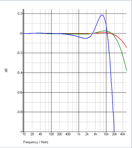

Vel, han har ihvertfall gått vekk fra at en lineær frekvensrespons er det ideelle. De resulterende eksperimenter med modifikasjoner i Orion's delefilter beskriver han slik:
Furthermore I have no explanation as to why there is a significant audible difference between the two response curves below, which differ by a maximum of 0.17 dB at 5 kHz. The yellow (!) response sounds non-engaging and muted compared to the green response which is used in Revision 3. It certainly points to the importance of consistency and tight tolerances in the manufacture of tweeters in order to duplicate what we found. In two locations and with different speaker setups and environments we have come to the same conclusion about the two curves. You might check this out after you have updated your ASP.
It makes me wonder whether we have come upon a pivot frequency and level difference that is appropriate for adding instrument harmonics to their fundamentals in the right proportions whenever the Auditory Scene is a reduced scale representation of reality. The volume control determines the scaling factor. With the volume control I set the size and distance of the Auditory Scene. What size is acceptable appears to depend upon the content of the 2 kHz to 4 kHz octave and upon distortion. The ear itself is non-linear and ear canal resonance amplification might trigger unpleasant sensations. I suspect there is some evolutionary purpose for sensing distortion. For whatever reason, the spread between what is plausible and what is artificial to my hearing has widened, both in terms of timbre and spatiality. The highest enjoyable volume level has increased significantly, but it varies between recordings. There remains an overall brightness that can easily turn into shrillness on some voices. It is not clear whether this is due to the loudspeakers, the recordings or our ears. This and the criticalness of the tweeter level adjustment is bothersome to my engineering sensibilities.
Jeg har etterhvert fått stor sans for den mannens intellektuelle redelighet og ingeniørmessige skikkelighet.
Modifiseringen av mine egne Orion-delefiltre opp til revisjon 3.2.1 er nå omtrent halvveis unnagjort og jeg er rimelig spent på resultatet. Jeg må si at jeg blir en smule betenkt over hvor hørbare SL sier at noen av disse ørsmå endringene i respons er. Greit nok at dette er den siste finpussen på en allerede ganske så slepen konstruksjon, men når jeg tenker på at kravet til nøyaktighet av kondensatorverdier ligger helt ned mot målepresisjonen til det dyre Fluke multimeteret som cobra2 brukte da han var generøs nok til å håndmatche kondensatorer for meg, får jeg for første gang på veldig lenge et aldri så lite snev av audiophilia nervosa. :-\ ;D Heldigvis har SL implementert en snedig justering av elementnivåer så evt. produksjonsvariasjoner for virkningsgraden på elementene skal ikke representere noe problem.

Interessant nok er den forskjellen i samme størrelsesorden som den typiske forskjellen mellom to ulike høyttalerkabler. Ulikt tverrsnitt kan gi slike avvik som følger høyttalerens impedanskurve, induktans kan gi en liten resonant topp som vokser og flytter seg nedover i frekvens med økende induktans med dipper på begge sider av denne toppen. Slik, for hhv tvinnede og parallelle AntiCables og noe med samme tverrsnitt og riktig mye induktans:
Virkningen av kabelpris lar seg derimot ikke simulere i Spice. ;)
