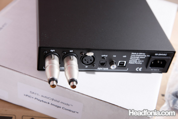

DA11 har ikke dedikerte RCA-utganger pga. plassmangel, men det følger med gode adaptere.

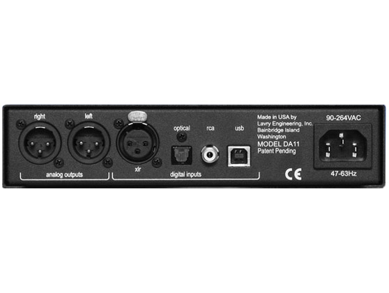

PRODUCT DESCRIPTION
DA11 Features:
  • [*=left]4 inputs: XLR, Optical, USB and RCA
    [*=left]USB up to 24 bits, 96KHz, recognized as "Lavry DA".
    [*=left](no driver needed), Works with Windows and Mac OS.
    [*=left]"Remote ready" for use with any universal remote control devices.
    [*=left]User selects balanced, unbalanced, Pin 2 hot or unbalanced pin 3 hot from the front panel, NO need to open chassis and move jumpers.
    [*=left]User controls signal inversion, display dimming, OUTPUT ON/OFF (for real panel output signals - HEADPHONE STAYS ON)
    [*=left]User friendly parameter setting:
    • Last setting stored in a memory for a future power up.
    [*=left]"Loud click elimination" protects both headphone and rear panel analog output during power up and power down.
    [*=left]UNIQUE FEATURE is PIC (Playback Image Control).

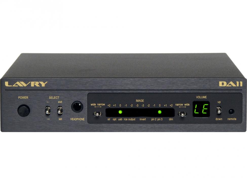

MORE ABOUT DA11:
While in most cases one would set the stereo image width with the same setting for Left and Right, I decided to offer separate Left and Right control, mostly for asymmetrical speaker setups. There are 6 settings for the left and 6 for the right.
+2 - widest (red)
+1 - wide (red)
0 - normal image (green)
-1 - narrow (yellow)
-2 - narrower (yellow)
-3 - narrowest (yellow)
Image switches operate horizontally making the "hand motion" of setting the image correspond to what one hears.
Image control, as well as volume and mute can also be set from a remote control.

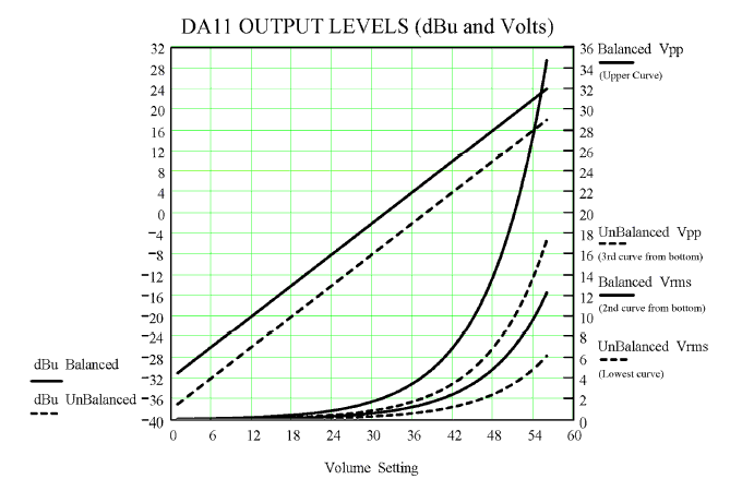

Volumnivåer
Ref.Jude The Lavry DA11: For your ears only
From the DA11 manual:
AES/EBU professional analog line levels:
Set to 56 for 24dBu balanced = 34.72V peak to peak = 12.28V rms
Set to 56 for 18dBu un-balanced = 17.36V peak to peak = 6.14V rms
A typical home power amp or powered speaker:
Set to 40 for 8dBu balanced = 5.6V peak to peak = 2V rms
Set to 46 for 8dBu unbalanced = 5.6V peak to peak = 2V rms
For most consumer equipment, I'd think that the 2V rms settings would be more typical. "56" may be more than your headphone amp or preamp wants to see into its inputs.
