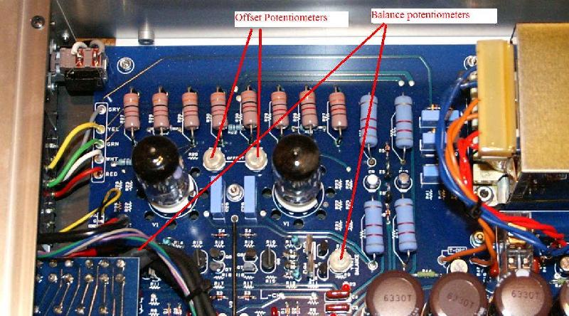

The tools I used were a philips screwdriver (to remove the cover), an insulated (plastic) slot head screwdriver (to adjust the internal potentiometers), and a good quality multimeter that is set to measure volts .... NOT AMPS!
Procedure I used:
I disconnected the headphones, unplugged the unit from the wall power, and using a Philips screwdriver, removed the four screws that hold the top.
I removed the two 6FQ7 (6CG7) tubes and replaced them with the new tubes (that were checked with a tube tester prior to insertion in the unit).
With the cover still off I plugged in and powered up the unit leaving it on for about and hour to stabilize. WARNING – at this point the cover is off and the unit is powered. I NEVER leave an electrical unit in this state unattended for any reason.
Below is a diagram of the earspeaker connector as it would appear if you were looking at it from the front of the unit. There are two of these connectors with the words “PRO ONLY” above them. They will not have "L+", "L-", "R+".... those labels identify the holes for the purpose of the discussion below.
WARNING - DO NOT under any circumstances put a probe into the socket shown on the bottom right labeled above as “Bias”. In fact, I covered it with a small piece of tape so that I wouldn’t have the possibility of an accident that could damage the unit or myself.
I set my multimeter to measure volts and inserted the positive probe into the slot shown above labeled “L+” and inserted the negative probe into the slot labeled “L-”. At this point I was measuring dc balance. My first measurement was in the 6 volt range, the reading could have been higher or lower, the goal is to get it under 1 volt. To adjust the value I used a plastic (NOT METAL) slot head screwdriver and adjusted the potentiometer labeled “TVR1” for the left channel. The potentiometer is EXTREMELY sensitive and the meter reading will have a tendency to drift around a bit. With some effort I was able to get the reading stabilized at about 0.250 volts.
I then removed the negative probe from the slot labeled “L-“ and attached the probe to the ground post labeled “GND” at the back of the unit. At this point I was measuring dc offset. Initially, the dc offset was around 1.5 volts. Again, the object was to get the dc volts under 1 volt. To adjust the value I used a plastic (NOT METAL) slot head screwdriver and adjusted the potentiometer labeled “TVR2” for the left channel. Again, the potentiometer is EXTREMELY sensitive and the meter reading will have a tendency to drift around a bit With some effort I was able to get the reading stabilized at about 0.090 volts.
I confirmed that the dc balance was still below 1 volt by removing the negative probe from the ground post and re-inserting it into the slot shown above labeled “L-”. If needed I could have adjusted the dc balance again and lowered it under 1 volt, but it still measured close to 0.250 volts. This process of going back and forth between the adjustment of dc balance and dc offset could have happened several times.
At this point the left channel adjustments were complete. I followed the exact same procedure for the right channel with similar results for the measured and adjusted voltages.
With both channels adjusted I turned off and unplugged the unit. With the unit unplugged I attached the top using the four screws and then plugged in the unit into the wall power and I was done.
