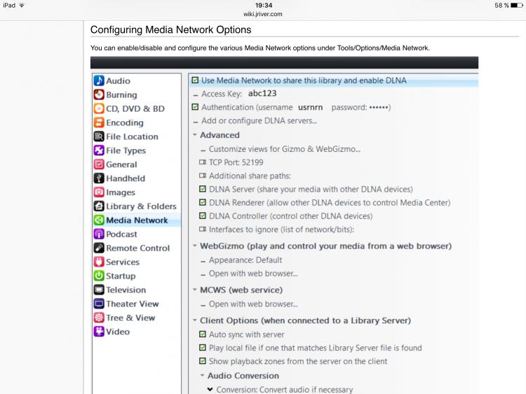

Takk for god hjelp. Det var en forskjell i ditt oppsett som det ikke var i mitt, og det var Authentification. Nå har jeg aktivert den. DNLA var allerede aktivert, det fant jeg ut på annen måte. Og som du skrev, jeg fant ut av det med filformat i menyene på selve Jriver. Da forsvant den opsjonen på Jremote, merkelig nok. Ikke at jeg trenger den, men bør den forsvinne?
Her er screenshot av mitt oppsett nå. Det må vel være greit?

OK, jeg var litt snar med info og linking i går. Nøkkelen er at chromecast ikke støtter det du vil gjøre, sånn uten videre. Du må installere en DLNA transkoder (bubble DLNa server) at jriver skal kunne gjenkjenne den som en sone.
Jeg hadde gitt deg feil link i går.
Siden noen allerede har skrevet en god guide på computer audiophile så unnlater jeg å refortelle: Computer Audiophile - Streaming Around The Globe Or Around The Home With JRiver Media Center
Streaming Around the Home
Problem:
I want to stream from JRiver Media Center to my $35 Chromecast Audio devices, up to 24 bit / 96 kHz as supported by the devices, with bit perfect digital output to my DAC via the mini-TosLink Chromecast Audio output, and use the JRemote iOS/Android app. Ideally the Chromecast Audio devices would appear as Zones within JRMC, the same way as UPnP/DLNA zones appear automatically. Transcoding my lossless library of FLAC, AIFF, an WAV files is unacceptable.
Solution:
JRiver Media Center supports UPnP/DLNA endpoints, but not Chromecast endpoints. Thus, it's impossible for my Chromecast Audio endpoints to appear as a zone in JRMC and receive audio without a little help. By installing and configuring the tiny, but very powerful, BubbleUPnP Server on my JRiver Media Center computer, my Chromecast Audio devices appear as UPnP/DLNA zones in JRMC. Once these devices appear as zones in JRMC, everything else falls in line. The JRemote app can select the Chromecast Audio devices and stream music to them as if they are true UPnP/DLNAendpoints. BuubleUPnP Server enables the full power of JRMC and JRemote to work with Chromecast Audio devices.

  1. Install and configure JRiver Media Center (if you haven't already) and enable DLNA.
    • Go to TOOLS > OPTIONS > MEDIA NETWORK.
    • Enable "Use Media Network to share this library and enable DLNA" (image)
