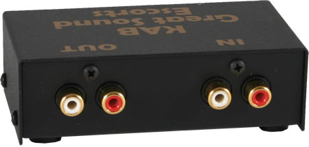

rico
Jeg har veldig god erfaring med denne, ikke bare med ny RIAA men også når man setter inn nye rør, sparer mange timer på P/U`en med denne.
The PreconLP™ is designed to convert a line level signal to a phono level signal with the proper inverse RIAA response characteristics. It is very accurate and has several applications in audio engineering and Hi Fi systems.
Used with a CD player and an appropriate burn in disc, the PreconLP can provide a burn in signal for your phono preamp.
Used with a signal generator, the PreconLP can provide a reverse RIAA signal suitable for testing the accuracy of any phono preamp.
The PreconLP can also be used to convert an unused phono input into a spare line input.
The output level adjusts automatically for MM inputs and MC inputs.
When sourced into a 47K load the output level will match moving magnet cartridges.
When sourced into a 100 ohm load, the output level will match low output moving coil cartridges.

vredensgnag
Vis vedlegget 184838
KAB Electro Acoustics http://www.kabusa.com
KAB-Pre Con LP Phono Burn-in Box-Turntable Set Up Tools | Acoustic Sounds
Sikkert en tilsvarende denne anmelderen anvendte.
