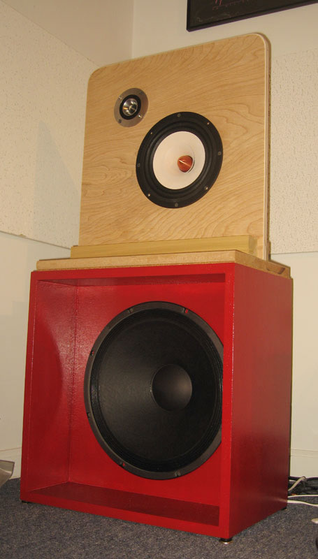

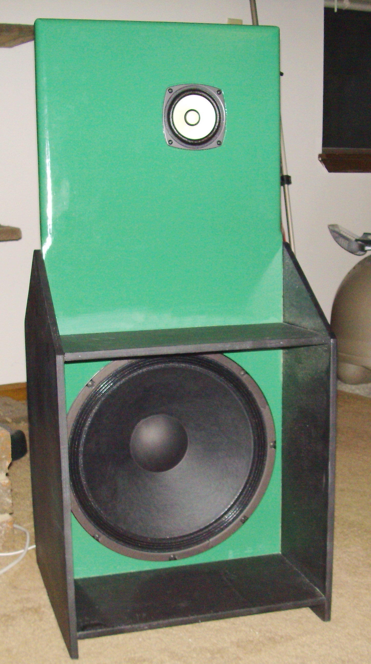

Fotoet viser Zilla Audio sin H-Frame. En slik skal jeg lage.
MJK sin oppskrift og måling: http://www.quarter-wave.com/OBs/U_and_H_Frames.pdf
+ En kommentar fra Zilla audio på DIYAUDIO.COM:
An observation i can offer is that crossing the H-frames lower sounds better. I use a typical sub amp (anything 100+ watts should be great) with variable crossover and volume. I did not want to figure the passive crossover and the sub amp does the trick for me. You will get an immense sound with these H-frames that has to be heard/felt to be appreciated. There may be better bass systems available but these really satisfy me. The 1808 will sound best with minimal interference from the H-frames... i really think the 1808 is a great driver regardless of how others feel about it. It's an ambitious attempt at a great sounding full range driver. It's a total pleasure to listen to.
