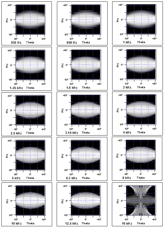

The horizontal coverage of the CBT36 is a function of the horizontal off-axis angle and actually gets narrower as you go off-axis. Heres a fig from my paper to illustrate that illustrates the sound field of a free-standing circular-arc CBT line array. Because the array is a ground-plane array the narrowing goes down to floor level, i.e. you get less and less illumination of the side walls as you go around the side. If you listen to the system on the side, it gets louder and louder as you squat down!
A complete set of ±60º horizontal x ±60º vertical footprint plots at all one-third octaves over the frequency range of 630 Hz to 16 kHz. In each footprint plot, the pressure in dB is normalized to the maximum in the stated angular range and is shown as a grey-scale density plot (high pressure in white and low in black).
