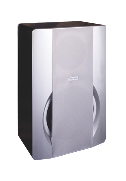

Velodyne har en lignende to-veis konstruksjon i sin 1812 Signature. 1x18" + 1x12" i trykkammer, hver med en 1250 W klasse-D forsterker og innebygget romkorreksjon. Ser ut som en søt liten bokhyllehøyttaler på bildet, men den er altså litt over meteren høy og veier 175 kg. Skal vistnok greie 100 dB ved 16 Hz...

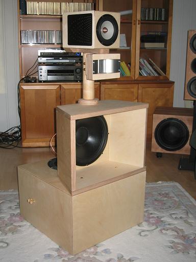

permorten skrev:
driftig fyr det der , synd jeg er så jæv... dårlig i - finsk ?
http://kotisivu.dnainternet.net/anukaa/index.html
Oops, my DIY speaker archive has been revealed :-\
That Alien2004 is ancient history, and demolished some years ago. Polar pattern of woofer unit was too much omni at 2 meters, and tweeter was also bad.
If you are looking for really well working cardioid bass, it's included in KS-585. Prototype of 'Variable volume resistance enclosure' and it's directivity measurements are introduced here. Scroll down until title "60 Hz resonaattori".
And sorry about English. I am able to recognize some Norwegian words, but not enough to understand what you are talking about my ugly monsters ;D
-Kimmo
