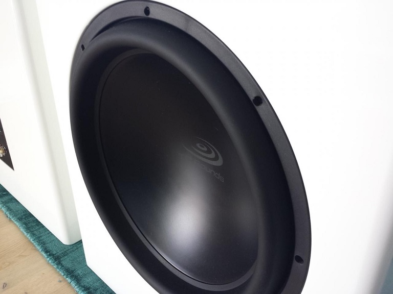

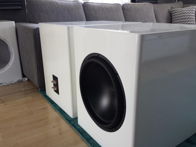

    The thread continues when I build new cabinets big ported 190liters instead for the Dayton drivers but my wife started to cry when I brought them home to our apartment so I sold them to a friend and made inserts to fit his TC Sounds LMS 4000 12" instead.
    The sonotubes was sold including the Dayton drivers and with the money I started to plan a new subwoofer build.
    Final result should look like this first picture
    Today 6months later they are back for the paint job.

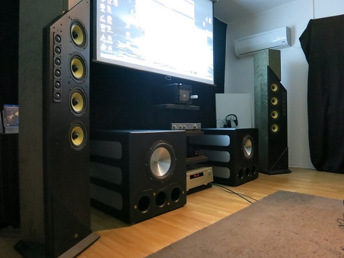

    Third build
    The subwoofers I use today
    Dual CSS SDX12 Hybrid Ported/Sealed
    HTS Forum
    Dual CSS SDX12 Ported/Sealed - Home Theater Forum and Systems - HomeTheaterShack.com
    Swedish forum picture gallery
    Minhembio.com - Hemma hos MattiasBGD - DIY Dual CSS SDX12 Subwoofers!

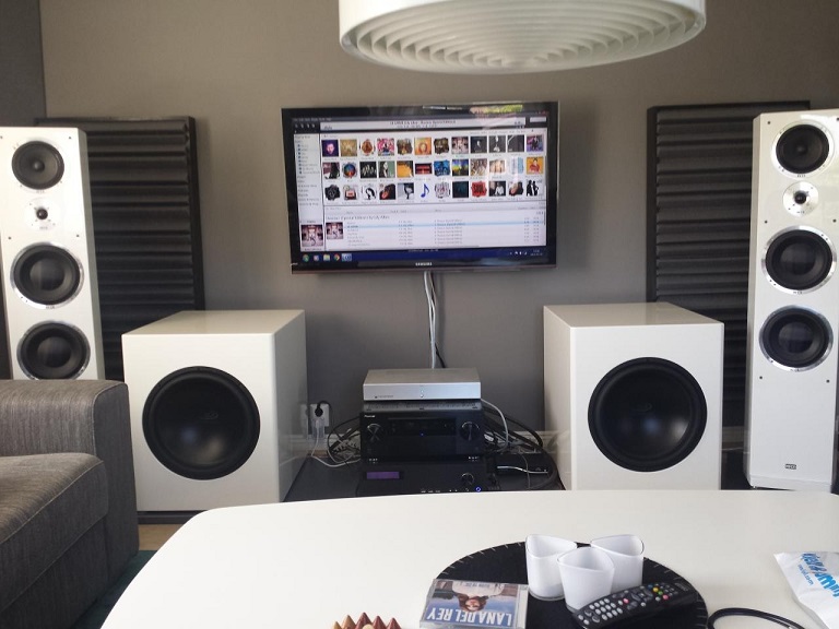

    Fourth build
    My woodshop friends subwoofers
    Dual Eminence LAB12 Hybrid Ported/Sealed
    HTS Forum
    Dual Eminence LAB12 Ported/Sealed - Home Theater Forum and Systems - HomeTheaterShack.com
    Minhembio.com - Hemma hos MattiasBGD - DIY Dual Eminence Lab 12 Subwoofers!
    Picture taken at my place before he picked them up.
