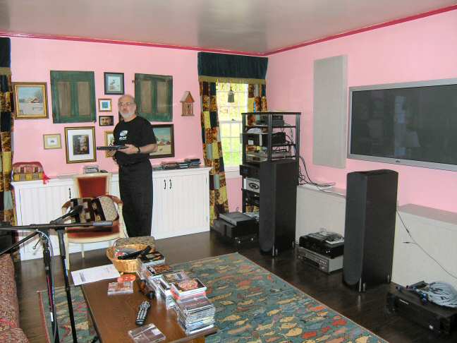

vredensgnag skrev:
Det sies at Kalman Rubinson besitter to av USAs mer spektakulære surround-rom.
I så fall har nok finanskrisen vært i overkant tøff for USA`s rikeste hjemmekinoentusiaster.

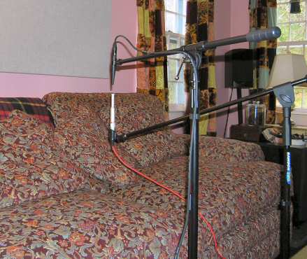

Ethan Winer skrev:
Kal's room is especially problematic, being nearly square at 15 by 16 feet and with an 8 foot ceiling
V
vredensgnag
;D
Det ser da strålende high-end ut. Jeg ventet på bildesvar fra deg!

Charles Hansen fra Ayre om multispilleren deres:
"There are a bunch of boards added on the audio side. I say "side" because we literally split the player into two parts. There is a separate power transformer that runs all of the audio circuitry, which is separated from the video side by a bank of opto-isolators. So the audio and video "sides" have separate grounds that are completely galvanically isolated. This is the only way to get the best performance from either your audio system or your video system.
All video displays have switching power supplies that dump noise into your system in the absence of such isolation. There are also ground loops that are inevitably formed as there is no such thing as a balanced video connection. All of those problems go away with our isolation system."
