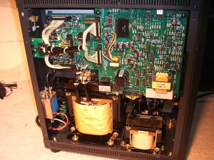

    Hva er inne i disse strømdingsene og hva gjør de egentlig?
    Først ut er Nordost Qx2
    Produsenten sier:
    QX2 and QX4 units are power purifiers that are affective Each QX unit contains QRT field generators (two in the QX2, four in the twice as powerful QX4) that alleviate the impact of poor quality AC power on your sensitive electronics, limiting RFI and timing errors
    without compromising the peak current capabilities of your power supply or the integrity of your grounding.

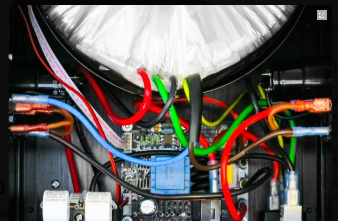

    Hva er så inne i:
    fra Nordost QX2 QX4 inside upgrade QX2 to QX4
    How this work?
    Inbound electricity does not flow through the entire system. Is from the board transfers directly to exit! Serves energised microcontroller and inductors.
    Electric from 70032K transformers (2*12V) flow to RS201L Bridge Rectifiers. From output bridge 17V go to L7805CV voltage stabiliser. This stabiliser set voltage on 5V for power supply microcontroller PIC16F54. First output from microcontroller switch two transistors, second output two next transistors. Each transistor is connected to: output microcontroller over resistor, ground and inductor. Inductors form a two sections. In each section have 1 inductor for QX2 and 2 inductors for QX4. Inductors are connected parallel in QX4. The idea of the device is switching outputs of the microprocessor and generating an electromagnetic field.
    Hva skal man si til dette? Ja , apparatet gjør tydeligvis ingenting med strømtilførslen da strøm/spenning går rett fra inngang til utgang uten noe inngrep.
    Det er noen spoler som lavspenning føres gjennom med en viss frekvens og genererer et magnetfelt. Takket være metall/ferritt? ringene holdes magnetfeltet innenfor spolen. Så rent teknisk så stemmer nordost sin beskrivelse "without compromising the peak current capabilities of your power supply or the integrity of your grounding." Strøm og spenning går jo kun gjennom en ledning og ut igjen. Og "contains QRT field generators " ja det dannes et magnetfelt, ja.
    Hvordan og om dette forbedrer noe mht strøm og lyd er diplomatisk sagt heller uklart. Men det blir kanskje en demo ett sted en gang..så får man høre og spørre

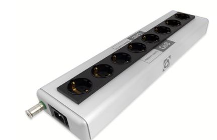

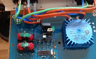

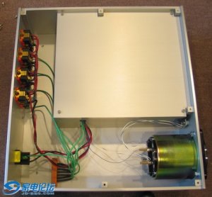

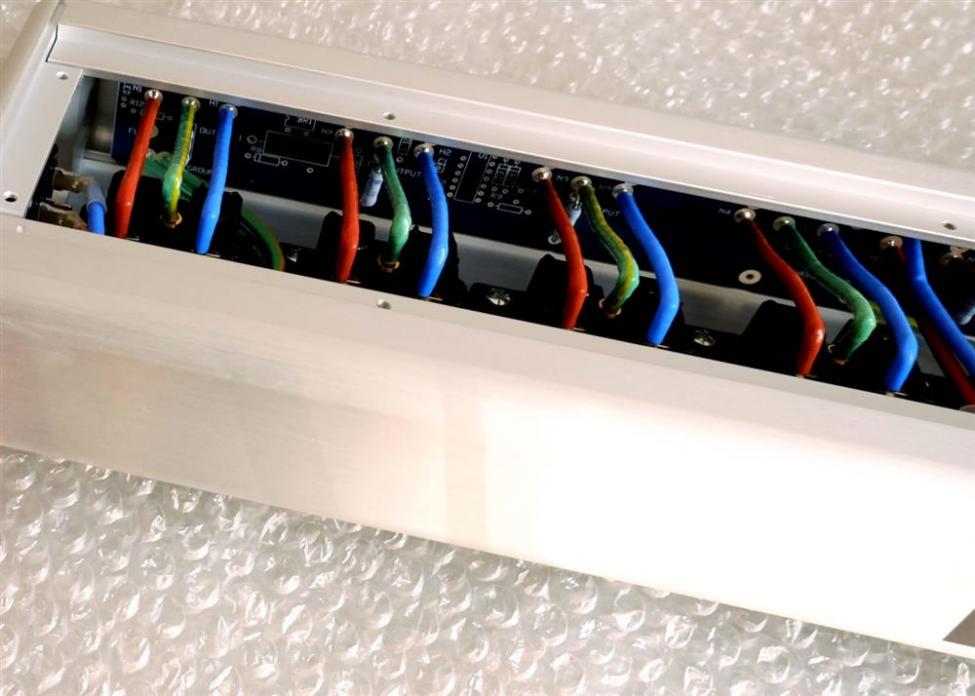

    Neste ut er strømskinne fra Nordost den også Qb8 til 18990 kr
    Fra produsenten:
    By eliminating any form of in-line filtering or active circuitry we maintain the lowest possible AC supply impedance, while a tiny lift in the earth impedance of all but one of the output sockets routes the signal grounds directly to the center of the star and the clean earth terminal. Clearly identified on the casework, this Primary Earth socket is at the center of your system’s performance, literally and metaphorically
    Vis vedlegget 463478
    Vis vedlegget 463477
    Bilden fra to ulike kilder viser at dette er en strømskinne/ fordeler og intet annet, så "By eliminating any form of in-line filtering or active circuitry" er riktig.
    På det ene bildet ser man også at uttakene til siden for midten/PRIMARY socket" har en motstand montert på jordingen. Dette et et triks som benyttes noen ganger i forsteker for å skille sikkerhetsjord og signaljord, uten at jeg kan si hvor bra eller dårlig det er. Google sier dette bla Groundloop problem solving: Ground lift circuits
    Så den lille mostanden til 2 kr er " a tiny lift in the earth impedance " som Nordost snakker om. Men legg merke til at groundliften er på sikkerhetsjord som IKKE inngår strømkretsløpet. Sånn er det med norsk strømnett som ikke har en LIVE og en NEUTRAL leder som i utlandet. men men...
    Så hvilken lydmessig effekt har dette da? Har hørt anlegg med disse,men ikke samme anlegg uten, så jeg vil ikke uttale meg om lyden,men det er vanskelig å forvente stor effekt utifra immaten ihvertfall.
    PS til denne prisen kunne man kanskje forventa at man får "stjernejord", på noen nettsider står det at det er dee, men bildet printet avslører ikke dette

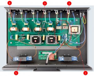

    Føler akutt behov for å bidra litt her:
    Shunyata Research Hydra 6
    Description
    Hear the Difference Pristine Power Makes!
    The Shunyata Hydra Model-6 incorporates all of the innovative design and technical elements--save Shunyata’s FeSi-1000 compounds-- that have earned the Hydra 8 its unprecedented array of critical awards and professional endorsements. Shunyata’s six proprietary cryogenically treated outlets are connected to the Hydra 6’s massive solid copper buss system, eliminating all point-to-point wiring.
    The Hydra Model-6 Trident Defense System provides noise-reduction with Shunyata’s best five-element Venom filter array, isolating and protecting each duplex outlet as independent power-sources. Statement-making surge and spike protection is passively implemented and totals a line-popping 60,000-amps of peak current protection. Rounding out the Hydra six package is enormous over-current protection in the form of Carling’s best hydraulic electromagnetic breaker.
    NOTE: Hydra Power conditioners do NOT come with power cords. This is because Shunyata believes that power cords are a component not a throw-away. We highly recommend that a Shunyata Hydra 6 be used with a 20Amp Shunyata AC cable to the wall for best performance. However, we understand that sometimes buying an additional power cord can put a strain on your budget, so upon request we can provide an inexpensive 14Ga power cord with a 20Amp IEC for only $20 that can be used until a better power cord can be purchased.
    Features:
    • 6,000 volts and 60,000 amps of surge protection
    • NextGen thermally protected TMOVs
    • Shunyata designed Venom filters (5-element)
    • Hydraulic electromagnetic circuit breaker (over current protection)
    • Each outlet individually filtered
    • Solid copper power distribution buss
    • Equivalent to an incredible 7-gauge wire
    • No point-point wiring
    • Detachable 20-amp power inlet
    • Power Rating: 2400 watts continuous, 20-amps continuous
    • 14 gauge all metal chassis
    • Professional rack mount faceplate
    • Threaded footers for after-market cones
    • All inlets and outlets mounted on back

    Bildene i særdeleshet viser vel hvilken grad av humbug som nå rår i bransjen. Det Shunyata "filteret" inneholder feks INGEN filterkomponenter i det hele...
    Nokså skremmende, faktisk...

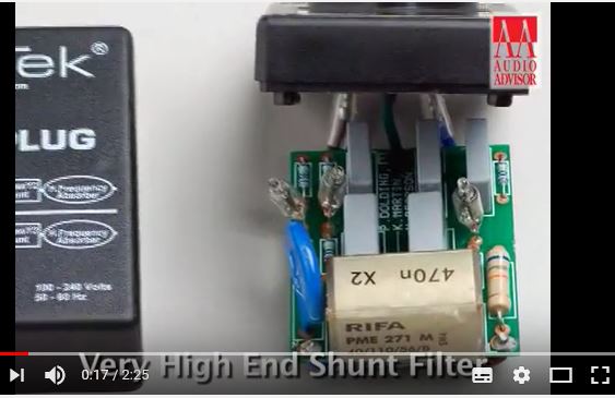

    W
    WayAhead
    Woooppsss . Shunyata Research har mottatt tonnevis med priser og utmerkelser ikke minst fra .... Michael Fremer.....
    http://shunyata.com/about-us/
    HIGH-END MEDIA ACCOLADES
    Positive reviews and media-awards are meaningful if there is an accumulation of awards from diverse publications over time. Shunyata products have earned a combined 23 media awards demonstrating consistent results over time. Some of the most recognized high-end audio publications, including The Absolute Sound, The Audio Beat, SoundStage!, Stereophile, HiFi Technique (Hong Kong), Audio Stream and HiFi Plus (UK) have given Shunyata Research major product awards, including Product Of The Year, multiple times. Editors Robert Harley (TAS), Michael Fremer (Stereophile), Marc Mickelson (TAB) and Lincoln Cheung (HiFi Technique, HK) are all regarded as having some of the finest ears in the industry. All of these industry luminaries not only chose Shunyata products, but have used them as their references for more than a decade.

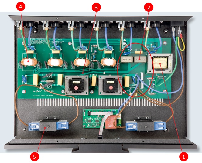

    Ellers er jeg sikker på at jeg ser i hvertfall en (1) varistor (kr. 4,50 eller så) inne i boxen
    E.H.
    04.07.2013
    671
    311
    Aurora
    04.06.2004
    14.889
    11.278
    Ytterst i havgapet...
    Bryteren er den grå greia... har en liten keramisk kondis over seg, det er det hele. Inntaket er ved siden av bryteren og er høyst ordinært....
    E.H.
    04.07.2013
    671
    311
    Det er jeg klar over, størrelsen på bryteren er såpass at det er plass til filterkondensatorer inni mener jeg.
    Sier ikke at det er det, eller at det rettferdiggjør pris eller påstått virkning, bare at en kanskje ikke skal avskrive det helt
    Fra produsenten:
    Vis vedlegget 463487
    Fortsettelse følger, neste er noe fra Isotek
    Nordost QB8 er en veldig godt konstruert strømfordeler med skikkelig aluminiumskabinett, Micro Monofilament strømkabler internt og stjernejord. Koster litt å lage en slik finish. Jeg tok med en QB8 til en venn av meg som har et rimelig surround-anlegg. Koblet fra en billig strømfordeler fra Brennenstuhl og koblet til QB8 med Furutech strømkabel fra vegg og strømkabel fra receiver inn på "Primary Earth". Vi fikk nesten bakoversveis av resultatet! Så mye større og renere lyd - det var stor forskjell enda han andre ikke har erfaring med dyrt utstyr fra før. Vi prøvde QB8 også med et miksebord på et større lokale, og med samme resultat der. Så kanskje verdt å sjekke ut før man avskriver denne helt? Nordost anbefaler alltid å starte med en QB4/8 som fundament i et hvert anlegg, og jeg forstår godt hvorfor! :)
    steinost
    22.01.2004
    11.302
    8.340
    Lillestrøm
    Rydd i kabelsalaten bak alteret så er det meste gjort.
    Det er der den største årsaken til støy ligger.
    Kristian
    30.10.2002
    447
    280
    Levanger
    32
    Det også! Men QB8 har absolutt noe (mye!) for seg. Reduserer jord-sløyfer mellom apparatene og maksimal leveranse av strøm med Micro Monofilament internt. Prøv selv!
    bambadoo
    11.10.2002
    22.120
    10.572
    Lørenskog
    Ja enig. Koster litt. Men bare bittelitt å lage noe slikt. Et par hundrelapper blir det jo.
    Solide greier.
    Men har sett mye værre fra den produsenten tidligere.
    De lyger jo ikke når de sier dette
    I grunn - ingenting. Bare et lite jordløft.

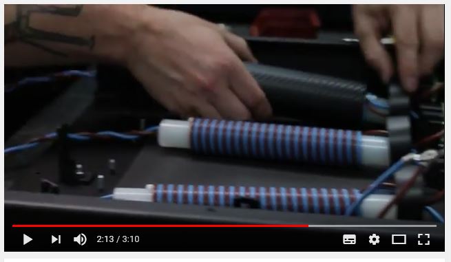

    Linker til denne enda en gang, jeg:
    https://youtu.be/XaRuFeEYTWQ

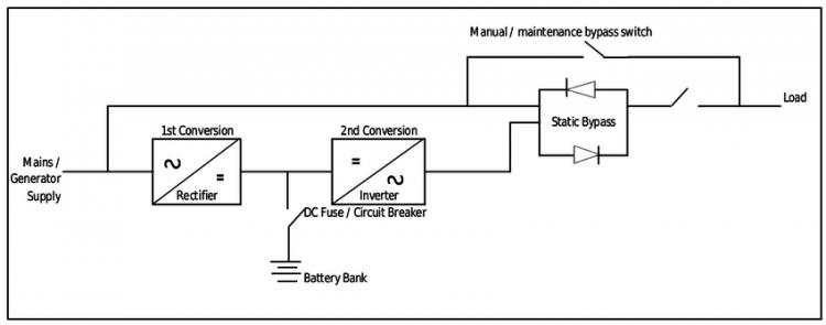

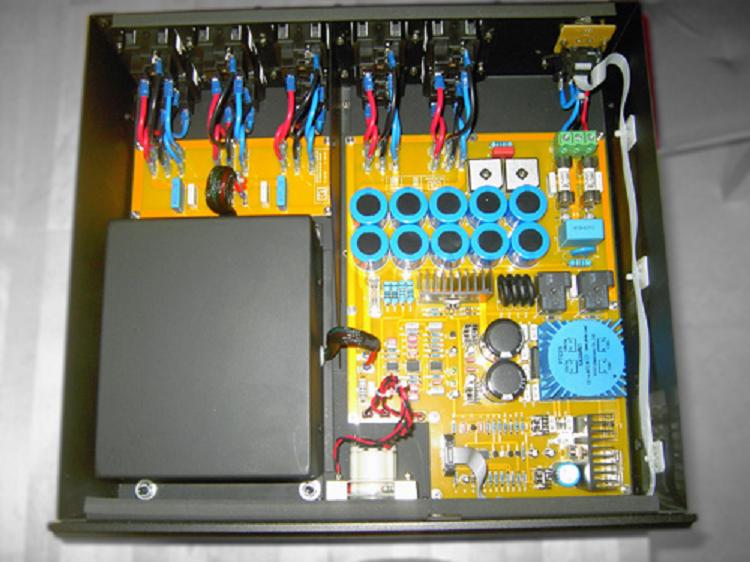

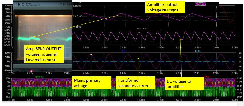

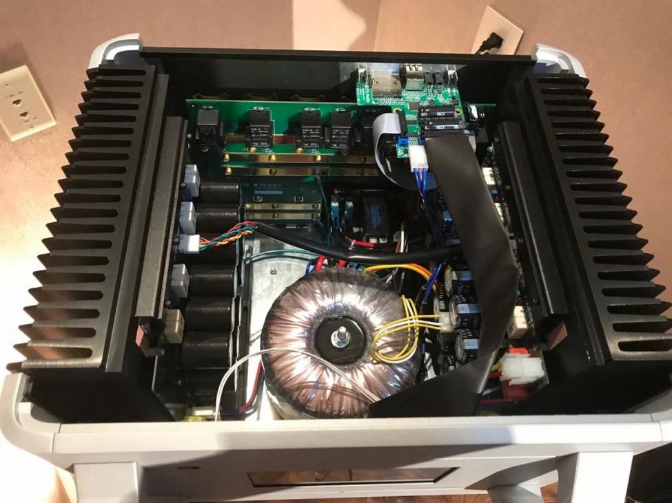

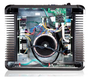

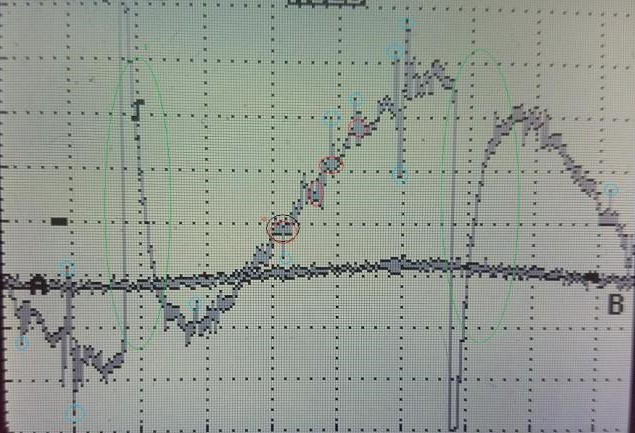

    Spørs også her helt hva som faktisk er på innsiden/skjema. I prinsippet kan dette være nok en stikkontaktboks men og men mulig det er en som gjør litt mer men det er ikke mulig å lese noe ut av infoen som er tilgjengelig på nettet.
    Denne her (under) gjør imidlertid om nettspenningen AC/DC og tilbake til DC/AC - rekonstruerer en perfekt PWM basert sinus med 56 kHz aktiv kurveformregulering ved dynamiske driftsforløp. 250% dynamisk strømkapasitet over max 100% RMS strøm. Den har i tillegg full galvanisk isolasjon.
    Og ingen er redde for å vise fram innmaten. Firmaet som lager disse ble etablert i 1925 og har alltid vært i det øvre teknologiskiktet innen Elektro/elektronikk.
    Aurora
    04.06.2004
    14.889
    11.278
    Det som er problematisk med dette, er bl.a. at det finnes andre store fagmiljøer hvor filtrering både er vanlig og utbredt, men hvor resultatene tilsier noe helt annet enn det som påståes innen HiFi.... hvordan blir det feks med selvmotsigelsen som oppstaår når man skal ha egne kurser med stort kvadrat til anlegget, mens man i neste omgang baserer seg på serieresistans i spoler og tildels svært tynn ledningsføring i disse filtrene?
    W
    WayAhead
    Alle slike duppedingser (ikke den over viste den = stivere enn nettet uansett) forringer nesten uten unntak impedansen, evnen til å dytte strøm inn til forsterkerene og de enhetene som trekker mindre (svært liten strøm i forhold) kan være langt mer følsomme for støy enn de tunge brukerene, sikkert ingen fasit der....
    W
    WayAhead
    P20 Re-generator internt:
    Utenom kjøleribbene ser den mest ut som en typisk Kinakonstruksjon men den ser ut til å ha en slags konverterfunksjon.
    De som lager enheten jeg viser til har arbeidet med profesjonell kraftelektronikkk siden slutten av 50 tallet.
    Denne enheten er helt klart ikke i samme leaget men mye mulig den kan løse noe.
    Uten tilgang på spesifikasjoner på strømkapasitet og reguleringstid/kapasitet/konstruksjon er det umulig å vite hva den er god for.
