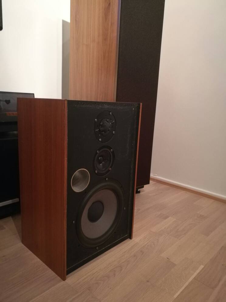

    Färdigrenoverade ser de ut så här:

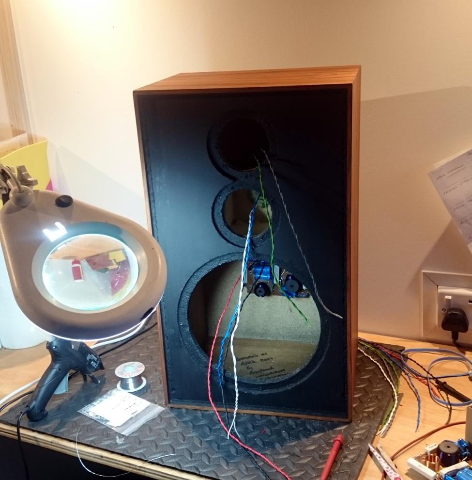

    Efter att alla element och delar tagits bort målas fronten (samma färg som innan). Vi låter baksidan vara i original. Fronten var dock lite ful då de gamla spikar som hållit grillen delvis haft sönder träet. Andrew monterar sedan 'banan anslutningar' på baksidan. Vi diskuterade att behålla de gamla originalkablarna med DIN kontakter men vi tror detta kommer ge bättre resultat.
    Delningsfilter i original:
    Delningsfilter med nya högkvalitativa kompontenter. Det var bara kondensatorerna som behövde bytas.

    Ett problem dök upp. Elementen satt inte fast ordentligt, de gamla skruvarna fäster inte. I en konversation med Andrew beslutar vi oss för hur det ska lösas:
    A: I am just re-assembling your Teac’s and the screws used for the drivers are not gripping very well due to the age of the cabinets. The ideal solution is for me to install threads into the cabinets and fit the drivers using high quality bolts, are you happy for me to do this?
    I have attached some photos so you can see what they look like.
    Alternatively if you would prefer me to use the original screws, I can secure them using wood glue in the existing cabinet holes.
    J: I think the thread and bolt options seems like a good solution, this is what I would think you recommend also.

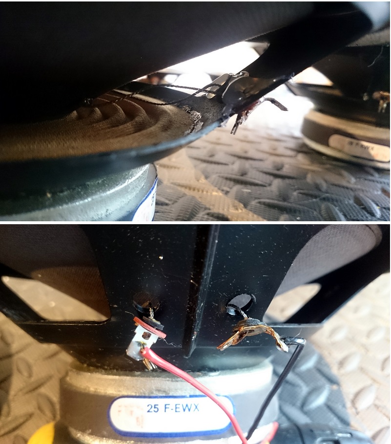

    A: I can’t remember if I mentioned to you that all the drive units in your Teac’s are made by Seas, a very long established, high end manufacturer of drivers so the restoration is certainly worth it. I have been cleaning and treating the drivers today so they will be performing well when I put them back in.
    I noticed that the wire tags on the bass drivers had come loose (see photos) so I have fixed them and made them secure again. I think they may have made a bit of a rattling noise at high volumes!

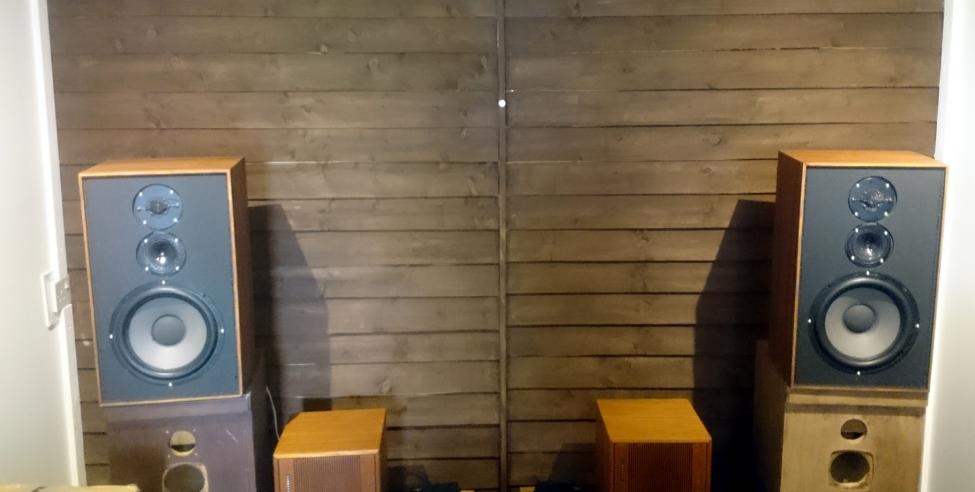

    Slutligen, äntligen klara!
    De fick kabinetten sandade oljade, nya ledningar dragna och omlödda inuti, nya anslutningar baktill, nya packningar och skruvar, filtren kontrollerade och nya kondensatorer, frontarna omklädda och fronten på kabinetten målade. Hoppas jag inte glömt något.
    Provlyssning. Andrew's omdöme direkt efter renoveringen:
    Your Teac’s have been set up in our lounge since yesterday and getting better all the time (see photo). They threw voices forward very well and created a very three-dimensional sound, impressive stuff.
    Andrew sade också när han provade dem i sin workshop att de var mycket lättlyssnade och angenäma. Nu när jag har dem hemma hos mig kan jag säga att de är fantastiska högtalare! Annars använder jag ett par Castle Kendal från 1974 med min Huldra 10. Teac'arna är ju 'closed box' vilket inte Kendal'sen är, de går inte att jämföra helt då de är två olika typer av högtalare, men båda är utmärkta partners med Huldran. Kendal'sen ger onekligen mer tyngd och bas, de låter 'mörkare'. Men Teac'arna har en riktigt bra diskant, de låter så lätt, luftigt och naturligt. Jag kommer att tänka på en sommar himmel i de Norska bergen.. De är mjuka i sin ljudbild, något jag verkligen uppskattar och som för mig är en av de stora anledningarna till att jag älskar 70-tals hifi, det blir aldrig hårt, men ändå så mycket detalj och krispigheten finns där, utan att vara skarp och kantig. Verkligen imponerande. De kan även spela djupt och med bas. Jag tror de gör sig allra bäst till jazz och akustisk musik, säkerligen även klassiskt (har inte provat än).
    Riktigt utomordentligt fina högtalare! Om du har ett par sådana här så ta vara på dem. De vinner stort på att få en översyn, framförallt tror jag nya kondensatorer i filtren, men även nya packningar lär göra stor skillnad.
    Nu låter de som högtalare som kostar många tusen kronor, om det ens går att få tag på moderna högtalare som låter så här..(?)

    Jag menade att de utgår från kit 303,men filtren skiljer något från min bild.Impedanskorrigeringen på mellanreg i dina filter tyder på att det skiljer sig något från de första filtren.
    Om fabriken beställde kitar eller lösa element från Seas har jag inte den blekaste aning om.Men kitar kunde fås som en kartong med bara element och filter eller med trätillbehör.Se bilden.
    Nu är det så att kit 303 utvecklades allteftersom tiden gick och finns därför i en massa varianter.Jag har sett olika mellanregister,basreflex,olika elementplacering.
    Troligen finns det flera varianter också på filter.
