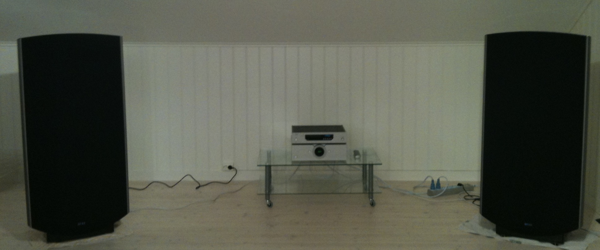

    Nå er mine 2905 med tilhørende Quad-elektronikk undervegs! Gleder meg etter 2 mnd. uten godlyd. Synd at jeg skal på ferie til helgen. ;D

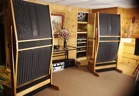

    Apropos forsterkere: Roger Sanders har noen interessante tanker rundt temaet ESL og effektforsterkere: http://www.sanderssoundsystems.com/ESL%20Amp%20White%20Paper.htm og http://www.sanderssoundsystems.com/ESL%20Amp%20Bias%20White%20Paper.htm
    Som dere antakelig forstår leverer Roger Sanders slike forsterkere til den som har behovet. Roger Sanders startet forøvrig firmaet Innersound etter at han forlot Martin Logan: http://www.innersound.net/, men har solgt seg ut av dette selskapet.

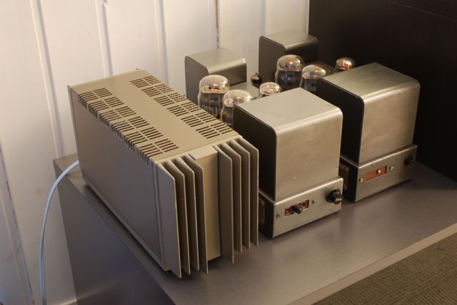

    Hei folkens.
    Jeg fant noen anbefalinger på effektforsterkere til Quads elektrostater her:
    http://www.quadesl.org/Amplifiers/AmpList/amplist.html
    Et lite utdrag:
    Amplifiers for Quad ESL-63 / ESL- 98 series
    Remarks : quite a kinder load than the original ESL , although the 63 and its successors still need stable amplification with power and control. A power rating of 40-100 watts is recommended anyway , tubes preferred. Two protection circuits prevent possible damage when high output amps are used .
    1. Recommended Vintage Stuff ( no longer in production )
    o Futterman H3, H3a, H3aa OTL
    o New York Audio Laboratories OTL-3 Q
    o Esoteric Audio Research 509 / 519 / 549 series ( all monobloks )
    o Goldmund Mimesis model 6 , model 9
    o Spectral DMC 50 , DMC 100
    o Classe Audio DR-2 , DR- 3 Class A
    o Stax Class A amps ( DA 80 and MA 80 monobloks , DA 300 )
    2. Recommended Contemporary Offers

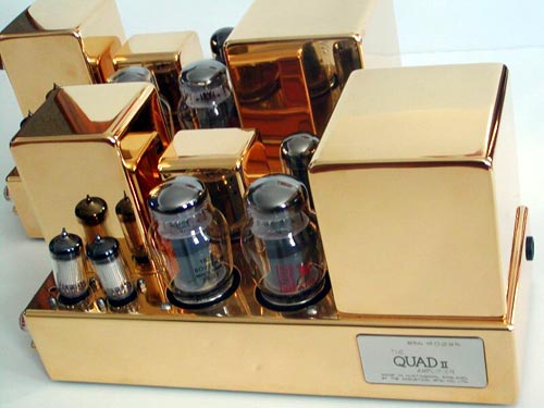

    o Quad II-40 monobloks
    o Vacuum Tube Logic ST-85
    o Esoteric Audio Research 861 Triode, bridged as monobloks
    o Esoteric Audio Research 534 Pentode, bridged as monobloks
    o Atmasphere OTL amps ( M-60, MA-1 )
    o Graff OTL amps ( GM-20 bridged as monobloks , GM-200)
    o Transcendence OTL
    o Inner Sound ESL amp solid-state
    3. Not recommended
    o Quad 405 ( stable , but mediocre sound - sorry Peter )
    Postscript :
    The list does not claim to include all suitable/ unsuitable amplifiers for Quads available somewhere in the world, only those known to the author and colleagues . For instance , the author tried several times to get Jadis , Audio Research and Conrad Johnson amplifiers for evaluation on the Quad speakers, unfortunately this has been impossible, because the companies / distributors showed not interest .
    Det er interessant at det nevnes en del OTL (output transformer less tube amp) forsterkere her. Roger Sanders (tidlgere Innersound ESL, nå: http://www.sanderssoundsystems.com) hevder i en artikkel (http://www.onethingaudio.com/OTA/9152-OTA-MAIN.htm ) at man bør unngå akkurat disse. Vel, her kommer hele artikkelen:
    Electrostatic speakers are essentially capacitors. Magnetic speakers are essentially resistors.
    Unlike magnetic speakers that maintain a nearly constant impedance, the impedance of electrostatic speakers is inversely proportional to frequency. Therefore at high frequencies, they present a very low impedance load to an amplifier (often less than 2 ohms).
    They also are highly reactive, which means that instead of converting the energy from the amplifier to heat in a voice-coil, they reflect it back to the amplifier's output stage. Compounding this problem is the fact that electrostatics have an out-of-phase drive characteristic whereby the current leads the voltage by 90 degrees. These characteristics tend to drive output transistors out of their safe operating area and can trigger protective circuitry or cause the output transistors to fail long before the amplifier has reached its rated power capability.
    Although electrostatic speakers are voltage-driven, they still require large amounts of current at high frequencies due to the low-impedance load. Since wattage is a function of volts multiplied by amps, suitable amplifiers will be rated for high power.
    Few transistor amplifier manufacturers design their amplifiers for driving capacitive loads. So you don't find specifications that tell you if the amplifier is suitable for electrostatics or not. But there are several clues that can guide you in the right direction:
    1) The output stage must be extremely robust. This means that it will have lots of output transistors (like 10 or more per channel). This allows the nasty load to be divided across many output devices, reducing the load on each and greatly improving reliability.
    2) The amplifier must develop relatively high voltages. Therefore it will be rated for high power since high-power amplifier require higher voltage power supplies than low-power amplifiers.
    3) Power MOSFET transistors do not suffer from the "second breakdown" phenomenon, therefore do not require protective circuitry. Since protective circuitry often misinterprets and triggers inappropriately on capacitive loads, the elimination of such circuitry is desirable. Note carefully that conventional bi-polar transistor amps can be designed without protective circuitry too and can perform better than MOSFETs in some ways (more linear with wider bandwidth and cooler operation). So MOSFET amplifiers are not essential, I just mention this as a way of being pretty sure that you won't have any protective circuitry involved.
    Note that the apparent build-quality of the amp has nothing to do with this. For example, I've seen expensive, 100-watt Levinson and Krell amplifiers fail on electrostatics while 300 watt Adcoms work just fine. So go for power above all else. Of course, if you can find an amplifier that is specifically designed for electrostatics (like the InnerSound Electrostatic Amplifier), then that is likely to be an excellent choice.
    Tube amplifiers are entirely different than transistor amps when driving electrostatic speakers. Their big problem is that their output impedance is too high, which severely limits their current capability and causes them to have very low power at the higher audio frequencies. Fortunately, there is not much energy in music at high frequencies, so even though they lose most of their power at high frequencies, they usually still sound OK.
    Because tube amps have so much trouble delivering sufficient current, the best tube amp will have lots of power. Also, high-power tube amps tend to have lower output impedance than low-power tube amps. You will want to use the lowest impedance output transformer tap available -- usually 4 ohm. OTL tube amps will have a particularly difficult time delivering a low enough impedance and their output tubes are easily damaged by electrostatic speakers. So they are best avoided.
    In summary, power is the most important factor. After all, it really doesn't matter how well-designed your amplifier is, or what fancy components are used in it -- if it is overloaded and clipping, it will not sound as good as a more powerful amp that is playing cleanly.
    Tydeligvid ulike oppfatninger her. Peter Walker hevdet vel at 100W pr kanal var tilstrekkelig. Min forsterkere leverer dette, men blir likevel varme og sikringskretsløpene slår ut om jeg spiller litt høyt.

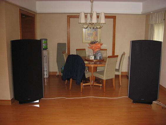

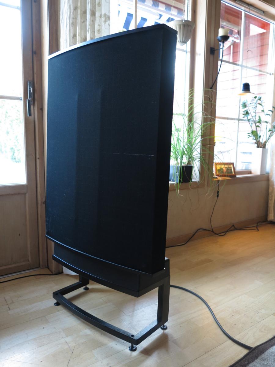

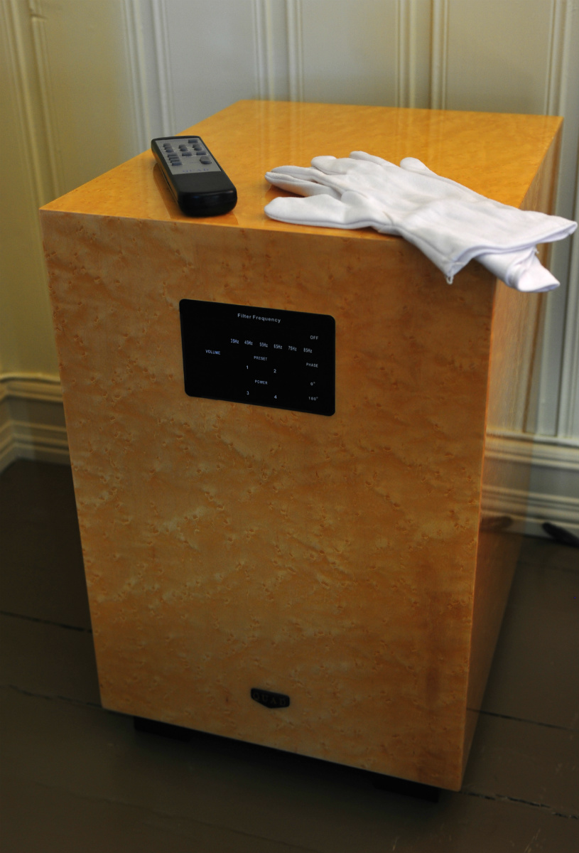

    Høyttalerne er kommet i hus! Wow! Det var heftige saker. Elektronikken ankommer om ca. 2-3 uker. Så foreløpig har jeg bare en Sony STR-DA 1200 ES til å drive de med. Selv med den låter det bra! Har kost meg og hørt masse musikk siden mandag, da jeg fik de hjem. Her kommer noen bilder tatt med mobilen fra hente/utpakking:(Se neste innlegg).

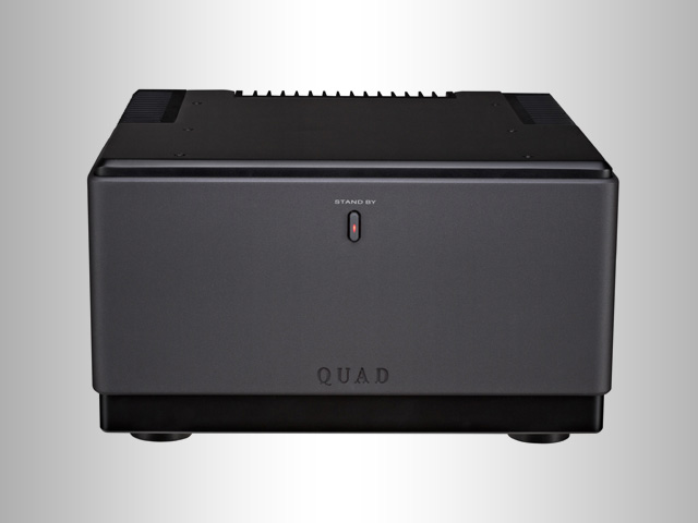

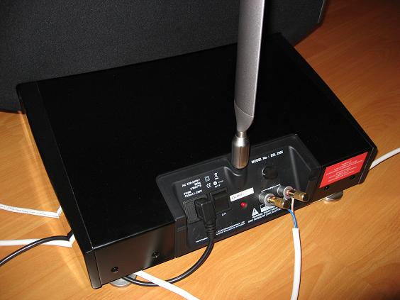

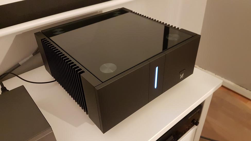

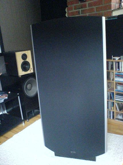

    Endelig er Quad elektronikken i hus. Etter å ha ventet i 4 mnd. har jeg endelig motatt 1 stk. Quad PRE 99, 1 stk. CDP 99 og 1 stk. Power 909. Var det verdt å vente på? Ja! Min stakkars Sony hjemmekinoreceiver STR-1200 et eller annet, har nok ikke maktet å hente kvalitetene på 2905 ut(hvilken overraskelse! :eek:) Nei, det kunne man vel ikke forvente, men dette var et gigantisk løft i lydkvalitet. Nå først skjønner jeg hvor gode disse høyttalerne er! Og det er sikkert mer å hente. Jeg er ikke så blåøyd, at jeg tror at min elektronikk tar det helt ut. Skal se om jeg i nærmeste fremtid får testet med Antique Sound Lab Monsoon som en kompis har(kjøpt av meg, hadde ikke Quader da). Kanskje er det match "made in heaven", håper nesten ikke det, dette begynner å bli dyrt :p Men er ihvertfall kjempefornøyd med mitt komplette Quad oppsett sålangt.

    R
    RL69

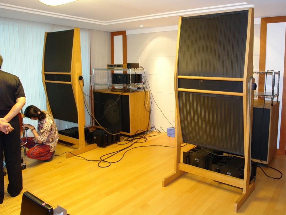

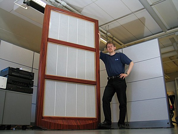

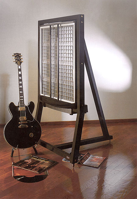

    Alastair Robertson-Aikman brukte elektrostater fra Quad i mange år.
    I et oppsett ble det brukt 2 par. Det ene paret plassert 90 grader i forhold til det andre. Mener å ha lest at han også brukte 70 kg messing pr høytaler for å stive av rammen og for å få opp vekten.
    Bildene er ikke store, men en kan se hvordan de er satt opp i forhold til hverandre.
    Mener også å ha lest at lytterommet hans var ca 80m2 .
    MVH
    KOL69

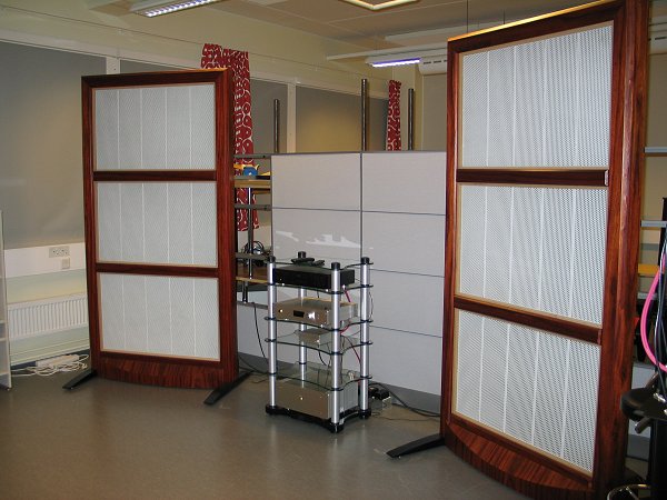

    R
    RL69
    Noen bilder av ML HQD
    2 ESL'er stablet oppå hverandre med Decca hornet plassert mellom panelene.
    24" fra Hartley kan skimtes neders til venstre.
    Et bedre bilde, men uten Hartley basser.
    Decca hornene som ble brukt til HQD.

    Heldiggris breuer! Et minne for livet :D
    KOL69; ja det er 30 (2x15) esl 63 paneler....!! og en mengde edeltre og edelt metall!!
