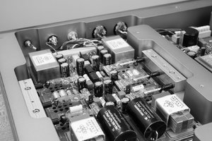

Advanced case design.
All tube amplification with six pieces of sub miniature vacuum tube.
