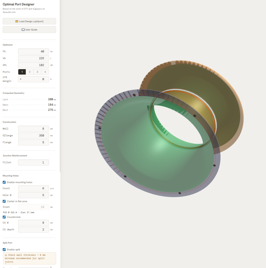

    Optimal Port Designer — User Guide
    Design optimized bass reflex ports for 3D printing. Based on the work of STV and Augerpro on diyaudio.com.
    Quick Start
    1. Enter Fb, Vb, and SPL from your favourite box simulation app
    2. Adjust port count if the port is too large for your cabinet
    3. Set wall thickness and flange diameter for your build
    4. Export STL for 3D printing or DXF for laser/CNC
    5. Remember — you do not want to scale the STL after exporting it. Unlike ordinary ports the optimized ports do not scale linearly on surface area vs length. If something is off with the size, just adjust in the tool and export a fresh STL. This convenience is why I made this tool.
    Sidebar Reference
    Optimizer
    The three inputs that define your port:
    ParameterWhat it isWhere to get it
    FbBox tuning frequency (Hz)Your box simulation (WinISD, Hornresp, etc.)
    VbNet box volume (liters)Your box simulation
    SPLTarget max SPL (dB)Based on your listening habits and driver + amp capability
    Port count (1-4) — Splits the total port area across multiple ports. Use more ports when a single port would be too large for your cabinet opening.
    When using multiple ports, the optimizer automatically adjusts per-port: enclosure volume is divided by the number of ports, and SPL is reduced by 6 dB per doubling.
    However, smaller ports come with real trade-offs:
    • More viscous and boundary-layer losses (proportionally larger in small tubes)
    • Less tolerance for 3D printing imperfections
    • Smaller absolute flare dimensions
    This is why one bigger port is generally preferred when it fits. The multi-port option exists for when a single port won't physically fit in the cabinet.
    Tip: Use the largest port(s) you can fit. If low coloration and low compression at high levels matter to you, consider making the box larger to accommodate a bigger port. Think of it this way: for a given diameter, this optimizer gives you the maximum port SPL before noise and compression set in. A larger port simply raises that ceiling.
    STR margin — Adds safety margin above the theoretical minimum Strouhal number. 0% = theoretical limit. +10-20% = conservative. Leave at 0% unless you're pushing high SPL and want extra headroom against turbulence noise.
    The effective bar appears when using multiple ports, showing per-port dimensions.
    Computed Geometry
    These are the optimizer's output — calculated automatically from your inputs:
    • Lact — Actual port length (mm)
    • Dmin — Minimum (throat) diameter (mm)
    • Dext — Exit (mouth) diameter (mm)
    The port profile is not a straight tube — it flares from Dmin at the inner end to Dext at the outer end, following an optimized curve that minimizes turbulence.
    Construction
    Physical build parameters:
    • Wall — Wall thickness (mm). 3-6 mm typical for 3D printing. Thicker walls recommended if using the split feature (8 mm minimum for threaded joints).
    • Dflange — Flange outer diameter (mm). Match this to your cabinet opening and the size of the inner aerodynamic flange — remember this gets rather large. Use 2D view for help-lines. Consider using the split function to get more port area for a given frontal area — you must have access to the inner part of the port to screw on the inner flange.
    • Flange — Flange thickness (mm).
    Junction Reinforcement
    • Fillet — Controls the fillet radius at the port-to-flange junction. Higher values = larger, smoother fillet. Adds strength and reduces stress concentration at the joint. Range 0-8.
    Mounting Holes
    Optional bolt holes in the flange for fastening the port to the cabinet.
    • Count — Number of holes (2-12), evenly spaced around the flange
    • Hole diameter — Bolt hole size (mm)
    • Center in flat area — Automatically positions holes in the flat part of the flange. You should play around with the inset feature to manually find a more optimal placement for your design.
    • Inset — Distance from flange edge to hole center (mm)
    • Countersink — Optional countersink for flush-mount screws (set diameter and depth)

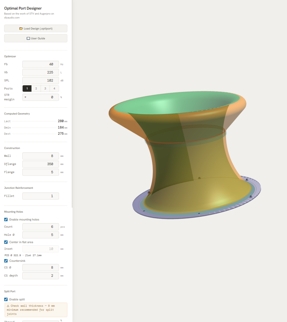

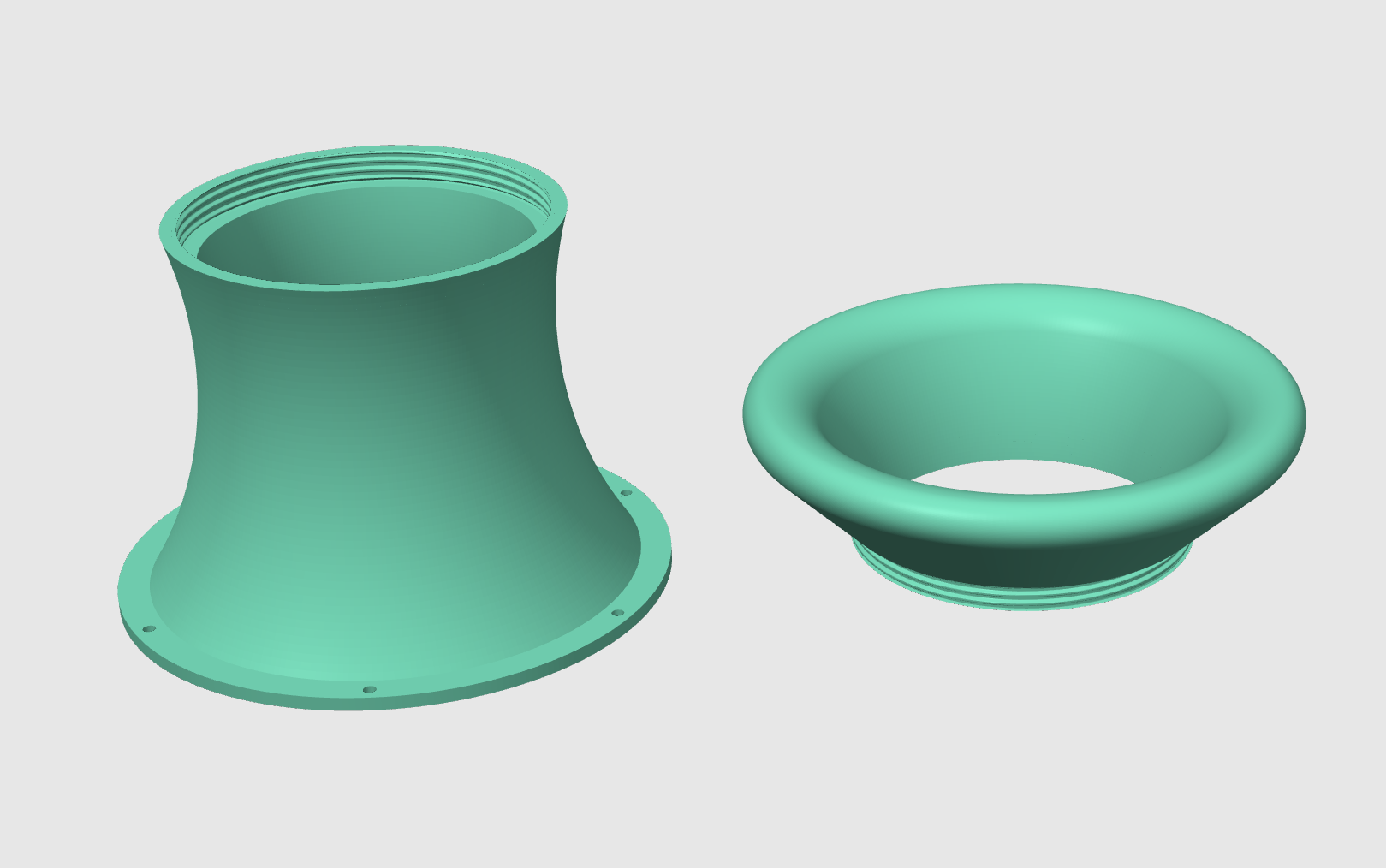

    Split Port
    Separates the port into two pieces that screw together with printed threads.
    Why split? The inner aerodynamic flare can get large relative to the exit diameter, forcing an oversized outer flange. If you want the largest possible port for a given cabinet opening, use the split function. You mount the main body first, then screw the inner part on from inside the cabinet.
    This requires access to the inner end of the port after mounting.
    Secondary benefit: the threads print fine using simple support. Printed with threads down this reduces need for support. If you are using mounting holes they may need support.
    Parameters:
    Play around with the parameters to optimize for your printer and filament. The standard settings are verified on Bambu Labs H2D and P1S using PETG and PLA matte. Warning — only tested on rather large ports yet.
    If you choose 2D view you can see the split between inner/outer threads. Helps with positioning using the thread pos placement.
    • Thread pos. — Where the split occurs along the port (% from inner end). 25-75%.
    • Depth — Thread depth (mm)
    • Pitch — Thread pitch (mm)
    • Clearance — Thread clearance for fit (mm). 0.3-0.5 mm typical for FDM printing.
    • Engage — Thread engagement length (mm). Longer = stronger joint.

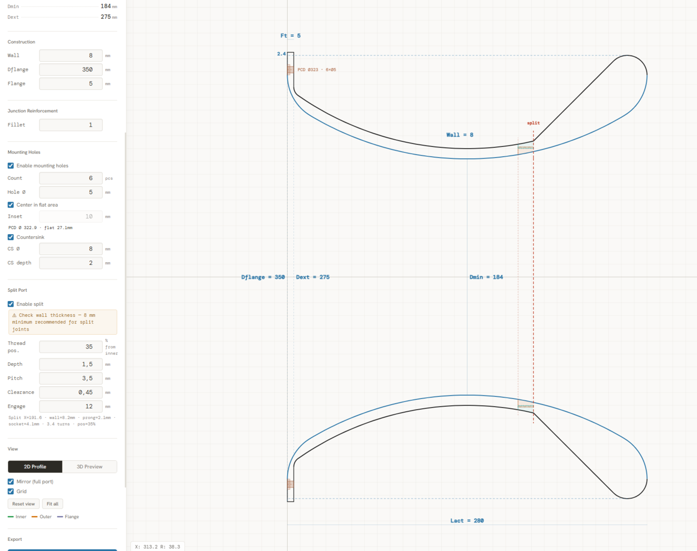

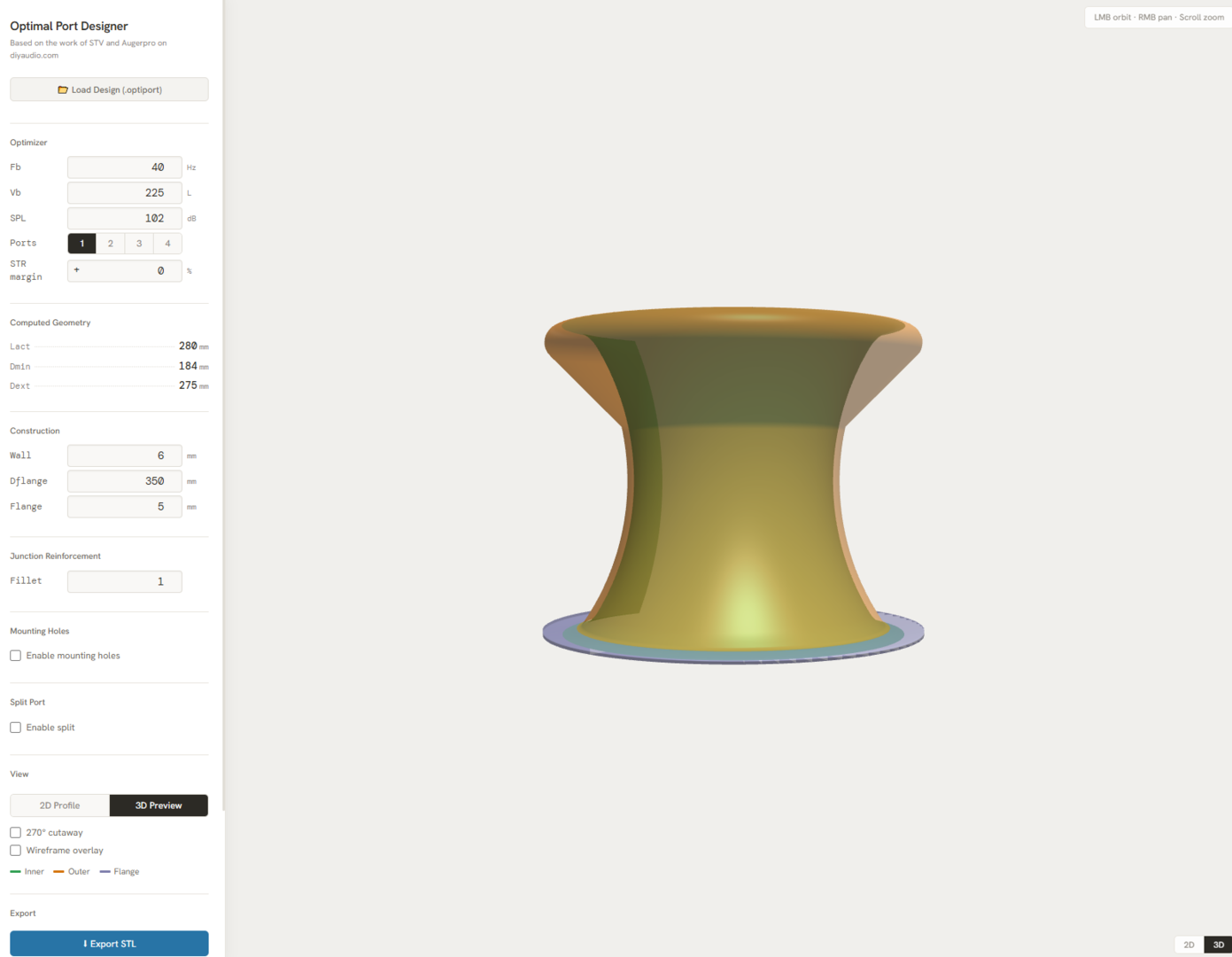

    View
    Toggle between two visualization modes:
    2D Profile: - Useful for dimensioning the outer flange. There is a reference line showing the size of the inner flange relative to the outer flange. This helps you with dimensioning the outer flange. Pay attention to having to re-optimize when activating mounting holes/countersink. - Cross-section view of the port profile - Mirror toggle shows the full port (both halves) - Grid overlay for dimensional reference - Pan and zoom with mouse - Cursor readout shows X position and radius
    3D Preview: - Full 3D model with orbit, pan, and zoom - 270 degree cutaway to see internal geometry - Wireframe overlay option - LMB orbit, RMB pan, scroll to zoom
    Export
    Three export options:
    • Export STL — 3D-printable mesh. In 3D view: full port. In 2D view: side profile.
    • Export DXF — 2D profile for CNC
    • Save As (.optiport) — Save your complete design for later. Load it back with the Load button at the top.
    Advanced
    Expandable panels showing:
    • Derived values — All calculated parameters (areas, ratios, correction factors)
    • Optimizer details — Convergence status showing how the iterative solver reached its solution
    Workflow Example
    Scenario: You're building a 2-way speaker with an 8" woofer. WinISD gives you Fb = 38 Hz, Vb = 45 L. Your amp does 200W into the driver's 91 dB sensitivity.
    1. Enter Fb = 38, Vb = 45, SPL = 105
    2. The optimizer computes the port geometry. Check if the flange fits your cabinet — if Dext is too large for a single port, try 2 ports.
    3. Set Wall = 5 mm for your FDM printer
    4. Set Dflange to match your planned cabinet opening
    5. Add 4-6 mounting holes, M5, with countersink if you want flush screws
    6. If the inner flange is still too large, enable Split — mount the main body from outside, screw on the inner flare from inside
    7. Check the 3D preview, toggle cutaway to inspect the internal profile
    8. Export STL, slice, print

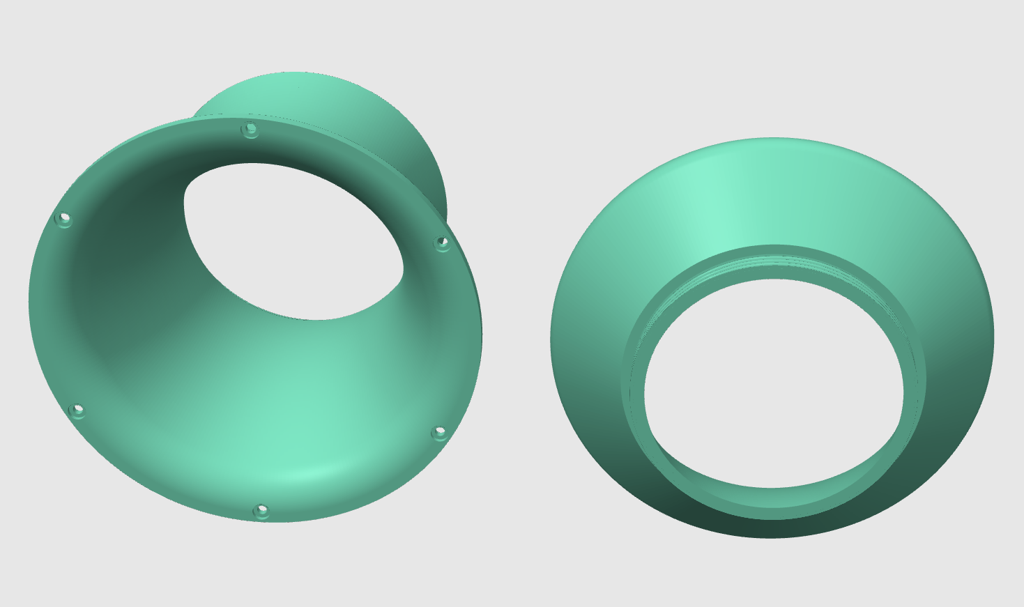

    Første forsøk er i skriveren nå :giggle: Den ble rimelig stor, 45Hz, 70 liter 95dB og delt.
