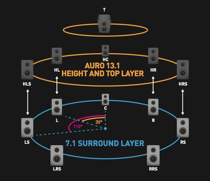

    Dolby Atmos og Auro 3D er to spændende formater. Jeg synes, at Auro 3D virker som det bedste. Er der nogle der har erfaringer med begge?
    Som jeg ser det, bør Atmos have fuldtoner i loftet for at have en ensartet spredning.
    Jeg har købt en Marantz processer og den har Dolby Atmos og jeg vil tilkøbe Auro 3D, fordi jeg vil høre musik fra 2L.

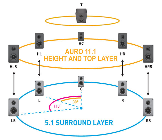

    Problemet er, at Atmos har 4 højttaler i loftet og Auro 3D har 4 over fronterne og surround højttalerne samt evt. en over lytteren kaldet "Guds stemme". Auro arbejder med 3 lag som nærmest en kugle.

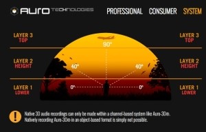

    AURO-3D

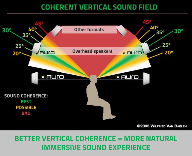

    Auro-3D is onits way to the U.S. and is taking a different approach to achieve a similargoal. Auro looks at sound in layers and adds a second layer of sound on top ofyour standard 5 or 7 channel system. Its kind of like stacking one surroundsystem on top of another. They achieve this with four bookshelf speakers, frontand rear left and rights, mounted on the wall above your current surroundsystem and angled down at approx 30 degrees.
    Aura Pros:
    1. Sound. Oursole experience came from Auro's room at the Venetian in Las Vegas. The demotook place over a 9.1 system (5.1 surround + 4 height speakers) with ahigh-quality demo disc. The experience was exhilarating. The demo disc actuallyincluded a/b comparisons with Auro on and off. Wow, what a difference! It wasthe closest simulation of reality that we've ever experienced. A pipe organ ina cathedral was 100% convincing, as was a symphony orchestra. A recording of aLondon street corner left you struggling to believe you weren't there. Ajetliner passing overhead made you want to hit the deck. It was so convincingit was almost scary. We felt this was a substantial leap towards ultimaterealism.
    2.Compatibility. Auro is compatible with a larger variety of rooms. Since you'rebasically just adding bookshelf speakers to the wall directly above your leftand right channels, you don't need to worry about vaulted ceilings or cuttingholes. The only potential for a problem is a room with a really low ceiling.You may not get enough separation between high and low speakers. We don't yetknow what the spatial requirements are.
    3. Sweet spot.Auro, from what we could tell, has a much wider sweet spot. We don't feel thata narrow sweet spot is a huge problem with Atmos (with in-ceilings) but we haveheard the issue mentioned on several occasions.
    Auro Cons:
    1. Cost. Toenjoy Auro, you'll need a minimum of 9 channels. Your choices are to either buya 9.2 receiver, or add a stereo amp to an Auro capable 7.2 receiver. That'sgoing to up the price right off the bat. Then come the 4 speakers. With Atmosyou can run a 7.2 receiver and you have the 2 speaker option to minimize costswhile still improving your sound.
    2. Space. Adding4 bookshelf speakers to your walls could be a really tough sell if your theateris also your family room. Most people face enough of a challenge just trying toadd a 5.1 system to the family space; let alone a 9.1 system. The sound isdefinitely worth it, but the footprint is much bigger.
    3. Lack ofsource material. Material is out there, but the selection is very limited. Wehave, however, heard that several movie studios have already signed on with Auro,which means more is sure to come.
    At this point,if sound were the only desire, we would recommend Auro-3D. But keep in mindthat that's only based on one demo with a carefully perfected demo disk. We'llcontinue to provide updates when we have more real-world testing under ourbelts.

    ATMOS
    Dolby Atmos is anew home theater speaker configuration that "transports you from anordinary moment into an extraordinary experience with breathtaking, movingaudio that flows all around you" according to Dolby. Basically you'retaking an existing surround system and either adding speakers in the ceiling,or on top of the front and rear channels. The ceiling setup has two options: 2speakers in the center, or one speaker in every corner totaling 4. Ifin-ceilings aren't an option, you can use reflecting speakers. You can placeone reflecting speaker on top of your front left and right channels, totaling2. Or you can place one on top of each of your front and rear channels,totaling 4.
    Atmos Pros:
    1. We found thatwith 2, or better yet, 4 in-ceiling speakers you will indeed increase youraudio dimensionality and create a more immersive experience. Airplanes,bullets, rain, etc. really will come from above you. You'll also notice moreaccurate sound placement than a standard surround system. Adding Atmos viain-ceilings is definitely a step towards the ultimate goal of realism.
    2. Cost.Receivers aren't cheap, especially when you get to 9 channels and above.Fortunately, you can get a 5.1.2 Atmos system (2 in-ceiling speakers) with somereasonably priced 7.2 receivers. For those of you that already own one, all youmay need to do is download a free update. If you want to have 4 in-ceilingspeakers, then you'll need a 9 channel receiver or an additional stereoamplifier.
    3. Space. Atmosis spatially efficient. Considering the fact that you're installing speakersinto the ceiling, an Atmos system is not very intrusive in your room. For somepeople, putting 5 speakers in a family room is a tough enough sell. Now if youwant to add more, at least they're out of sight.
    Atmos Cons:
    1. Compatibility. Atmos is not compatible with every room. Actually, to achievethe desired results, you really need a fairly specific room with a flat ceilingno lower than 9 to 10 feet. Unfortunately, if you have vaulted ceilings, youmay be entirely out of luck. For those of you who can't install into yourceilings, you're faced with a less desirable alternative, which brings us topoint #2.
    2. Reflectingspeakers. We're not big fans of this approach. That's not to say it can't work.We just feel the results are inconsistent and less fulfilling than the in-ceilingsystems. We found that the reflecting speakers don't achieve the desireddispersion commonly leaving you with a narrow sweet spot. So one seat may soundgreat; its just too bad for anyone not sitting in it. Also, we didn'texperience the same level of definition as we did with the in-ceilings. If youask us, we'll say that firing sound directly at you is definitely more optimalthan bouncing it off of another surface.
    3. Lack ofsource material. Right now there's only a few movies actually recorded inAtmos. Obviously this will increase over time, but how do we know somethingbetter won't come along in the meantime?

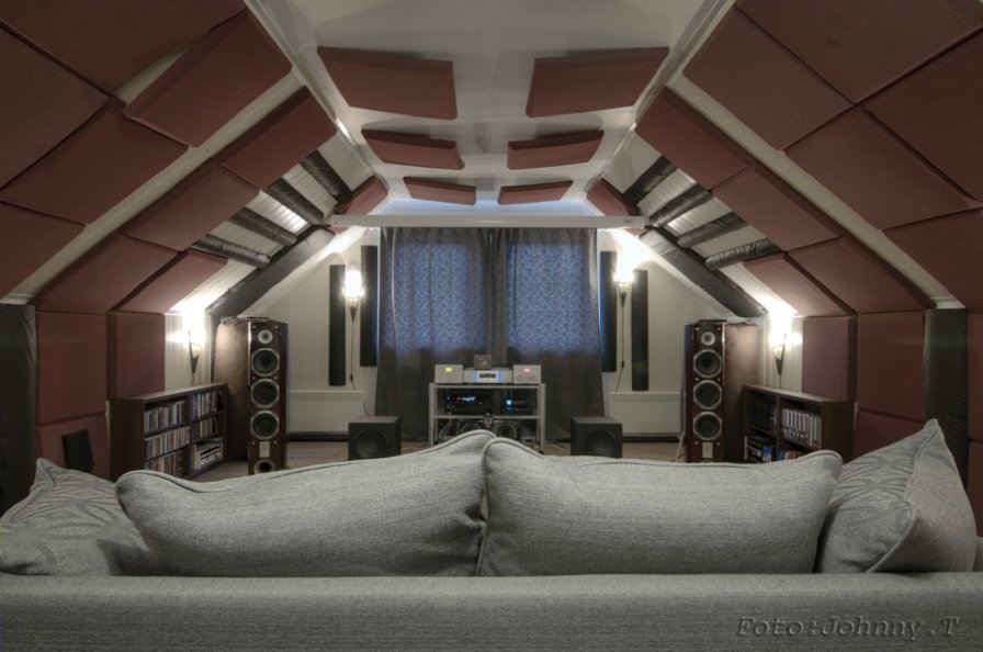

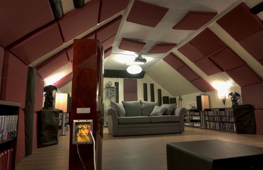

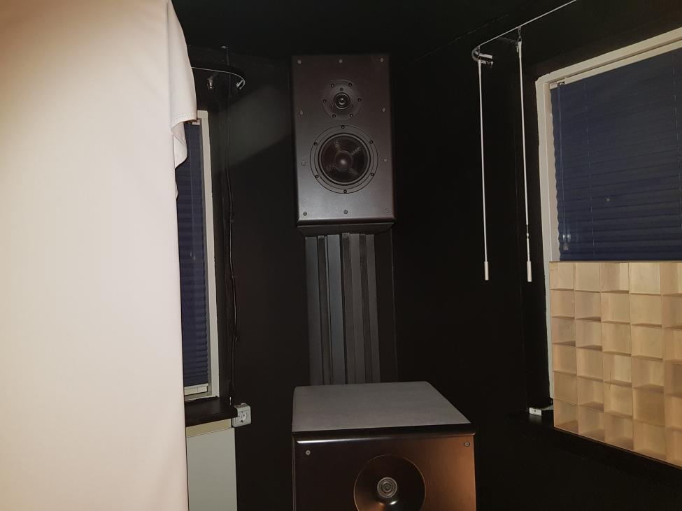

    Er det mulig å få plassert høyttalere til Auro3D og Atmos/DTSX riktig siden jeg har skråtak og relativt langt og "smalt" rom.
    Bilder fra gamleoppsettet. Men vegger er de samme.;D
    Vurderer å hoppe inn på de nyeste lydformatene. Men ser på tegninger at Auro3D i vertfall kan bli utfordrende å få til.

    Har symmetri OCD...
    Kan man henge opp auro på skråtak? Skal de vinkles inn mot sweetspot?

    Ja. De beste reciverne / prossesorene gjør målinger og regner ut vinkler og sånt.
    Auro3D og Voice of god vil jeg tro ut fra hva de viser på bilder og demo klipp kunne kjøres som Phantom høytaler.
    Forsøkte med Auro3d klipp lastet ned fra Demo World.
    Har Atmos oppsett og DSU oppskalering av lyden. Og opplevde da klart hva Auro3D er tiltengt uten og ha Auro3D oppsett.
    Der er det i klippet Helikoter og et fly som kjøres i taket. Heftig den flypasseringen. Og da er det bare 4 Atmos høytalere.
    Det er bare hvordan en skal plassere for og kunne kjøre alle de 3 nye formatene uten noe plasserigsvasnker.

    Er vel et par år siden dette oppsettet sto her. Savner dette innimellom.
    Dagens oppsett er mye mer morro og engasjerende og er nok også mye riktigere i forhold til musikksmaken i 2 kanaler
    Tar man med film så er valget enkelt.
    Mulig halvparten av høyttalerne ryker ut idag. Har lysst å teste noe nytt og prøve å få til enda litt mer raffinert lyd. Synes RF7 maler lyden med litt bred pensel innimellom. Dessuten så tror jeg at jeg har begynt å bli gammel. Hører mindre og mindre på den tyngste heavy metall. Selv om den er der. Blir mer og mer gitarbasert rock bluesrock. Som kler klipsch godt. Men har hørt noen oppsett i 2015 som har litt mer nyanser.
    Uansett OT og litt mimring.
    Blir det atmos og auro så blir det nok en reciver med innebygde trinn. Pluss effekttrinn til de kanalene som trenger mest guffe. Har en del kanaler stående. Ser litt på Marantz sr7009 da jeg liker marantz lyden. Men Arcam har noen virkelig spennende recivere på gang. Med korreksjon fra Dirac.
    Får se hva det blir til.
    Det et jo fremdeles relativt nytt. Så kanskje man burde sitte på sidelinja litt til...

    Er det ikke noe med at auro 3d og atmos ikke har kompatible plassering av høyttalerne? Mener å ha lest at du må rekalibrere når du skal bytte format.

    Stemmer nok det. Etter hva jeg har lest meg til så må man velge format og plassering.

    Hej Retep
    Med dit lytterum, virker det ikke til, at du kan bruge Dolby Atmos, (desværre), med det loft du har. Det er i hvert fald noget problematisk. Det ser ikke ud til, at du har de af Dolby anbefalede 2,3 meter til 3,66 meter til loftet. Til fladt loft... Dolby anbefaler så, højttaler der sender lyden op mod loftet. Det er blevet frarådet mig og det virker også egentlig fornuftigt. Du skulle gå for, tror jeg, Auro 3D med en egentlig loftshøjttalerlige over lytte positionen.
    Men dit rum som ses på billedet på side 1, er det oplagt en god mulighed for Auro 3D, da Auros højttalere peger ned imod lytteren og du har plant over lytte positionen.

    SVS Sound anbefaler faktisk at droppe loftshøjttalere i et Dolby Atmos setup, og i stedet for loftshøjttalere at placere højttalere på væggenhelt oppe ved loftet.
    Det gør man jo faktisk også i Auro 3D.
    Der er et par interessante betragtninger her, jeg har sakset fra en vens skriverier:
    http://www.svsound.com/blogs/svs/75358787-intro-to-dolby-atmos
    Ud fra Dolby egne tegninger for placering af højttalere i et 7.1.4setup, så ser det ud til at loftshøjttalerne faktisk sidder ret tæt påsidevæggene, så måske er SVSound’s ide om højde-side-højttalere ikke helt dum.
    http://www.dolby.com/in/en/guide/dolby-atmos-speaker-setup/7-1-4-setups.html
    Specielt hvis man ikke har de Dolby Atmos anbefalede 2,3 til 3,66 meter til loftet og mulighed for luft mellem bagvæg og lytteposition – så fraråder Dolby brug af loftshøjttalere og anbefaler Dolby Atmos enabled højttalere (hvor man ”skyder” lyden op på loftet fra side-/fronthøjttalerne).
    Men langt de fleste fraråder brug af Dolby Atmos enabled højttalere, alle de steder jeg kan finde noget god information om emnet.

    Taket ( loftet) mitt på den flate delen er 239cm. Skråteket har 34 graders helling ( mener jeg det var) og knevegg er 120cm.
    Bredden på det flate taket er 185cm. mens bredden av rommet vel er 460cm.
