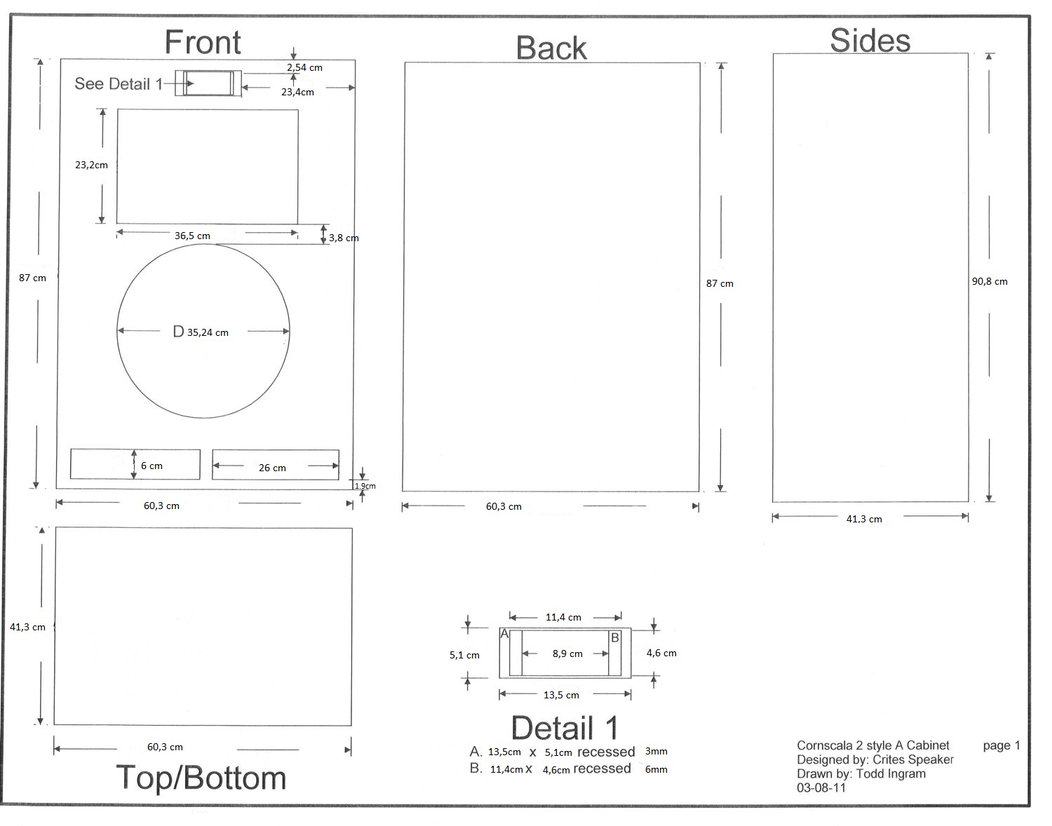

    Kassene blir bygd i mdf etter denne tegningen.
    Så alle tips til finish er kjærkommen informasjon :)

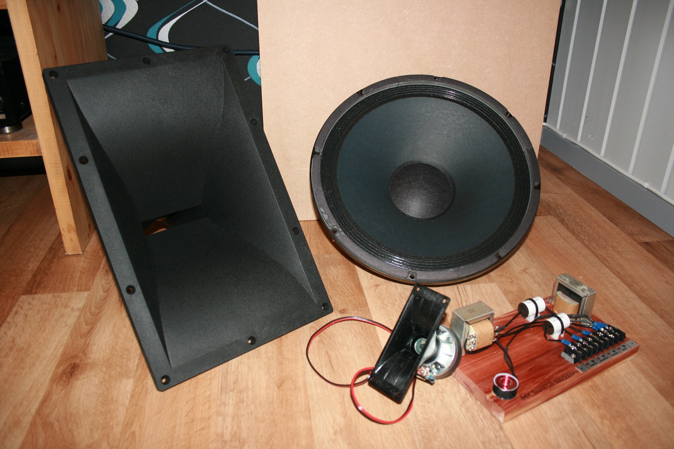

    Det er et puslespill og sette sammen dataene for dette prosjektet men det jeg har til nå er
    Bass ht
    CW1526C cast frame.
    FS is 26.3, Re is 3.36, VAS is 506.3 Liters, BL is 12.49, QM is 9.93, QE is 0.27, QT is 0.26. Sensitivity is 97 db. Coil is 1 mH.
    Pmax is 150 watts. Xmax is 7.15 mm, MMS is 75.5 grams, Cms is 0.486 mm/N

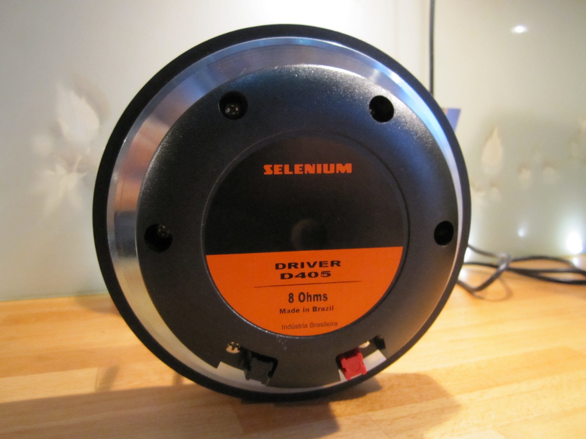

    Mellom tone Selenium d405
    SPECIFICATIONS
    Nominal impedance. . . . . . . . . . . . . . . . . . . . . . . . . . . . . . . . . . 8
    Minimum impedance @ 2,900 H z . . . . . . . . . . . . . . . . . . . . . 6.8
    Power handling
    Musical Program(w/ xover 500 Hz 12 dB/ oct) . . . . 150 W
    Sensitivity
    Frequency response @ -10 dB . . . . . . . . . . . . . . . 300 to 7,000 Hz
    Musical Program(w/ xover 1,000 Hz 12 dB / oct) . . . 200 W
    On horn,1W @ 1m, on axis . . . . . . . . . . . . . . . . . . . . 110 dB SPL
    On plane-wave tube,1mW . . . . . . . . . . . . . . . . . . . . 116 dB SPL
    Throat diameter . . . . . . . . . . . . . . . . . . . . . . . . . . . . . . . . . 50 (2) mm (in)
    Diaphragm material . . . . . . . . . . . . . . . . . . . . . . . . . . . . . . . . . . . . . . . Phenolic
    Voice coil diameter . . . . . . . . . . . . . . . . . . . . . . . . . . . . . 100 (4) mm (in)
    Re . . . . . . . . . . . . . . . . . . . . . . . . . . . . . . . . . . . . . . . . . . . . . . 6.0
    Flux density . . . . . . . . . . . . . . . . . . . . . . . . . . . . . . . . . . . . . 1.60 T
    Minimum recommended crossover (12 dB / oct). . . . . . . . . 500 Hz
    Magnet material . . . . . . . . . . . . . . . . . . . . . . . . . . . . . . . . . . . . . . Barium ferrite
    Magnet weight . . . . . . . . . . . . . . . . . . . . . . . . . . . . . . 2,640 (92) g (oz)
    Magnet diameter x depth . . . . . . . . . . . . 200 x 24 (7.87 x 0.95) mm (in)
    Magnetic assembly weight . . . . . . . . . . . . . . . . . 7,740 (17.06) g (lb)
    Housing material . . . . . . . . . . . . . . . . . . . . . . . . . . . . . . . . . . . . . . . . . . . Plastic
    Housing finish. . . . . . . . . . . . . . . . . . . . . . . . . . . . . . . . . . . . . . . . . . . . . . . Black
    Magnetic assembly steel finish . . . . . . . . . . . . . . . . . . . . . . . . . . . . Zinc-plated
    Voice coil material . . . . . . . . . . . . . . . . . . . . . . . . . . . . . . . . . . . . . . . . . . Copper
    Voice coil former material . . . . . . . . . . . . . . . . . . . . . . . . . Polyimide (Kapton )
    Voice coil winding length. . . . . . . . . . . . . . . . . . . . . . . 7.0 (23.0) m (ft)
    Voice coil winding depth . . . . . . . . . . . . . . . . . . . . . . . 4.1 (0.16) mm (in)
    Wire temperature coefficient of resistance ( ). . . . . 0.00329 1/°C
    Volume displaced by driver. . . . . . . . . . . . . . . . . . . . 2.2 (0.078) l (ft )
    Net weight . . . . . . . . . . . . . . . . . . . . . . . . . . . . . . . 8,300 (18.30) g (lb)
    Gross weight . . . . . . . . . . . . . . . . . . . . . . . . . . . . . 8,520 (18.78) g (lb)
    Mellomtone Horn
    Heter M2380 og skal være en kopi av JBL2380 hornet ut over det har jeg ikke forsket så mye på saken
    satser på at ferdig konseptet passer meg fint :)
    Diskant
    Crites CT-125 diskant bruker en Eminence driver som har en følsomhet på 104db/1w
    mere info om den har jeg ikke funnet.
    Delefilter
    Deler ved 500/5000hz så mye mer enn det har jeg ikke funnet ut. Satset på en ferdig konstruksjon fra Bob Crites.
    legger ved pdf fila til selenium driveren for de som er interessert

    Tenkte jeg skulle legge ut pdf fila som mellomtone hornet skal være en kopi av.
    Regner med at noen med mer peiling en meg arresterer meg. Hvis jeg har blingsa og sprer feil informasjon ;D

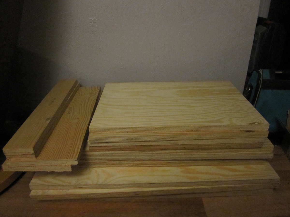

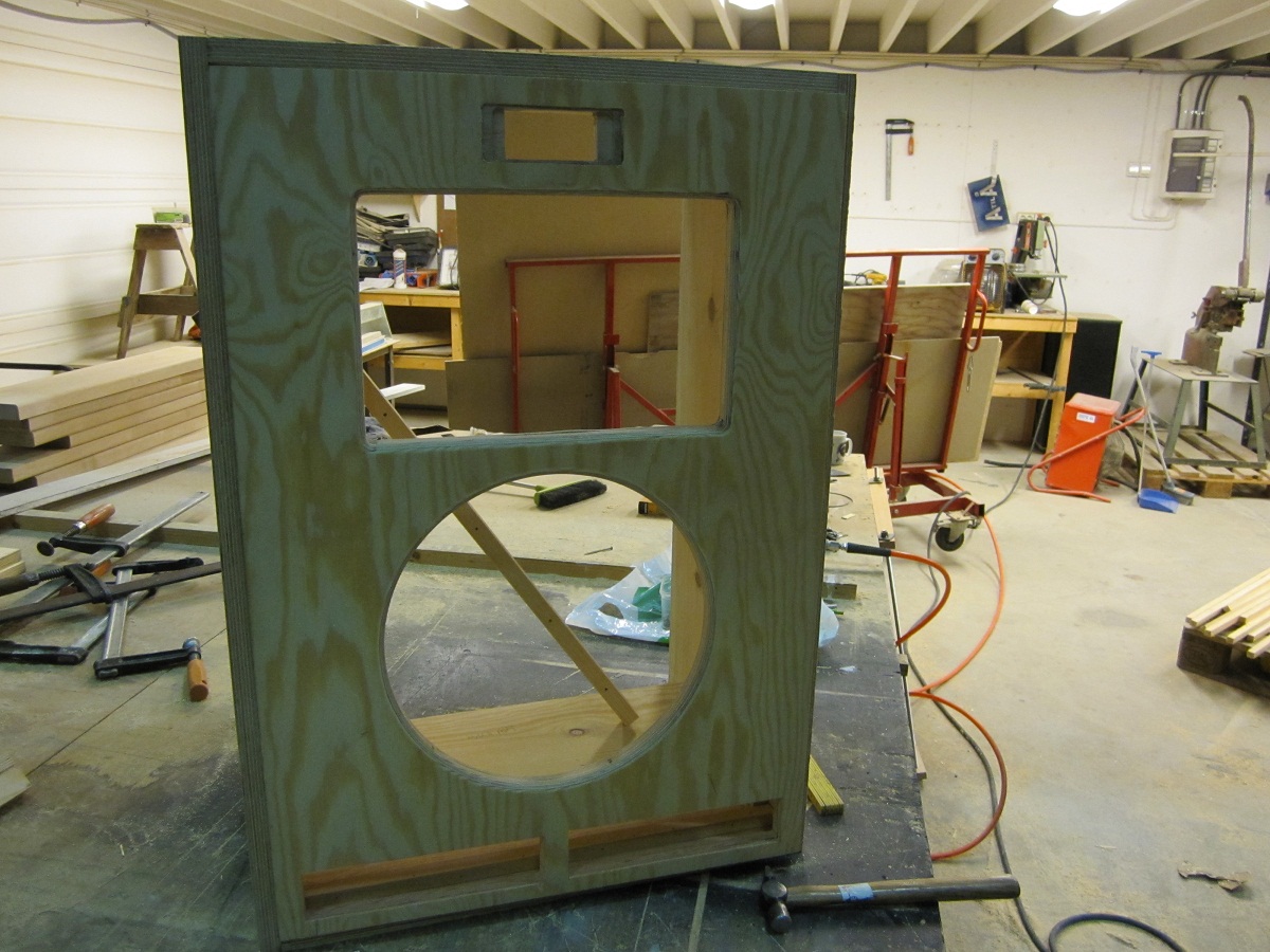

    Da ble det handla inn 22mm furu kryssfiner i dag i god kvalitet mange lag og rimelig tunge.
    Så da går mdf ut med høye kneløft ;D
    Det vil nok gjerne argumenteres for at det burde vært bjørk.
    vel vel mulig det, men etter å ha lest litt og hørt litt på folket rundt omkring.
    Så er vel kryssfiner uansett bedre enn mdf. Så da burde jeg være på rett vei tror jeg.
