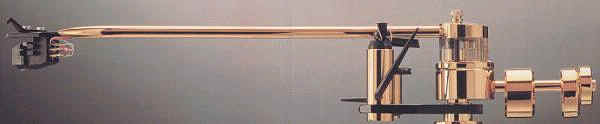

MØRCH has introduced a new top model: The DP-8
On the 4th of July 1981, Hans Henrik Mørch sent out a new tonearm to his auditioners. It was a prototype, a UP-4 modified to have greatly improved deep bass performance. But at that time audio equipment was not very concerned with the deep bass reproduction of vinyl records - the auditioners did not hear much improvement, and the project was abandoned. Somewhat ironically the introduction of digital audio helped advance the quality of deep bass - for instance, subwoofers are now commonplace. After 25 years the old prototype was dusted off and eventually became the DP-8. The improvements in deep bass and dynamics are now evident...
For this new model the effective mass for the horizontal mode of motion is many times larger than the effective mass for the vertical mode of motion - no matter the effective mass of the armtube used. This provides for tremendous improvements in bass response and a lot more dynamics.
The DP-8 got the Golden Ear Award in The Absolute Sound June/July issue 2010. In the article, the author refers to the DP-8 as "anisotropic", which is a short technical way of characterizing the new features.

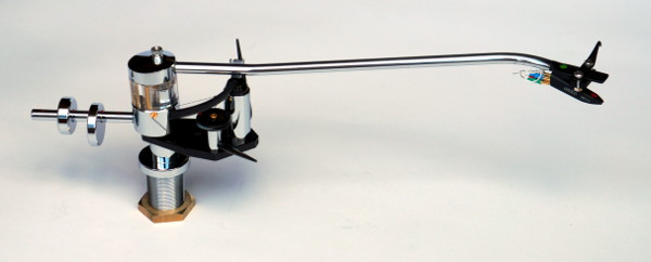

Mørch UP-4
Model UP-4 incorporates a special concept of the unipivot principle. The bearing consist of a hardened steel pivot resting in a concave, polished sapphire. The bearing is damped in all directions with silicone fluid. The low positioning of the bearing provides for a greater stability compared to other unipivot arms, since a considerable part of the moveable mass of the arm is positioned above the pivot point.
With the model UP-4 the azimuth adjustment is made by the way of the counterweights.
Supplied in CHROME- or 24 carat GOLD finish and at speciel orders also in BLACK.
The armtube plating being made without the use of magnetic materials.

Mørch DP-8
While playing a record, the tonearm must be able to move both horizontally and vertically – horizontally as the cartridge moves towards the center of the record, and vertically to allow for imperfections (warps and bumps) in the record.
At very low frequencies the modulation in the record is only horizontal. If the tonearm can move too freely horizontally the low frequency motion of the stylus will be transferred to the cartridge itself, while the cantilever of the cartridge almost does not move, and thus only a weak signal is induced.
To have excellent audio reproduction at these low frequencies, the horizontal movement of the tonearm must be restricted – but to ensure perfect tracking this must be achieved without a similar restriction of the vertical movement. This “anisotropic” principle – different characteristics for different directions of movement – is the essence of the MØRCH DP-8.
The DP-8 has a flywheel shaped central body and two weights on the sides to stabilize the movement of the tonearm horizontally. Thus, as the cartridge moves towards the center of the record, it can only follow the average location of the groove. It cannot follow the modulation, which is all transferred to the cantilever. This means that all the recorded bass, even the very low end of the range, is reproduced with full amplitude and dynamics.
Model DP-8 has a unique combination of bearings: For the horizontal mode of motion a silicone damped high precision ball-bearing assembly increases the stability provided by the large housing and sideweights. For the vertical mode of motion two precision sapphire bearings are incorporated. (The vertical mode of motion also may be damped. However, it is highly recommended not to do this for model DP-8.)
Model DP-8 has an integrated device for adjusting the VTA while playing. Markings for "getting back" to a special setting is provided.
The feature with different weights of armtubes to optimize the tonearm for any cartridge is maintained. Thus warps will not influence the tracking force, and there will be no vertical deflection of the cantilever.
In model DP-8 the azimuth adjustment for perfect channel separation is accomplished at the pivot of one of the sapphire bearings.
Supplied in CHROME- or 24 carat GOLD finish.
Pris fra kr 58 295,-
