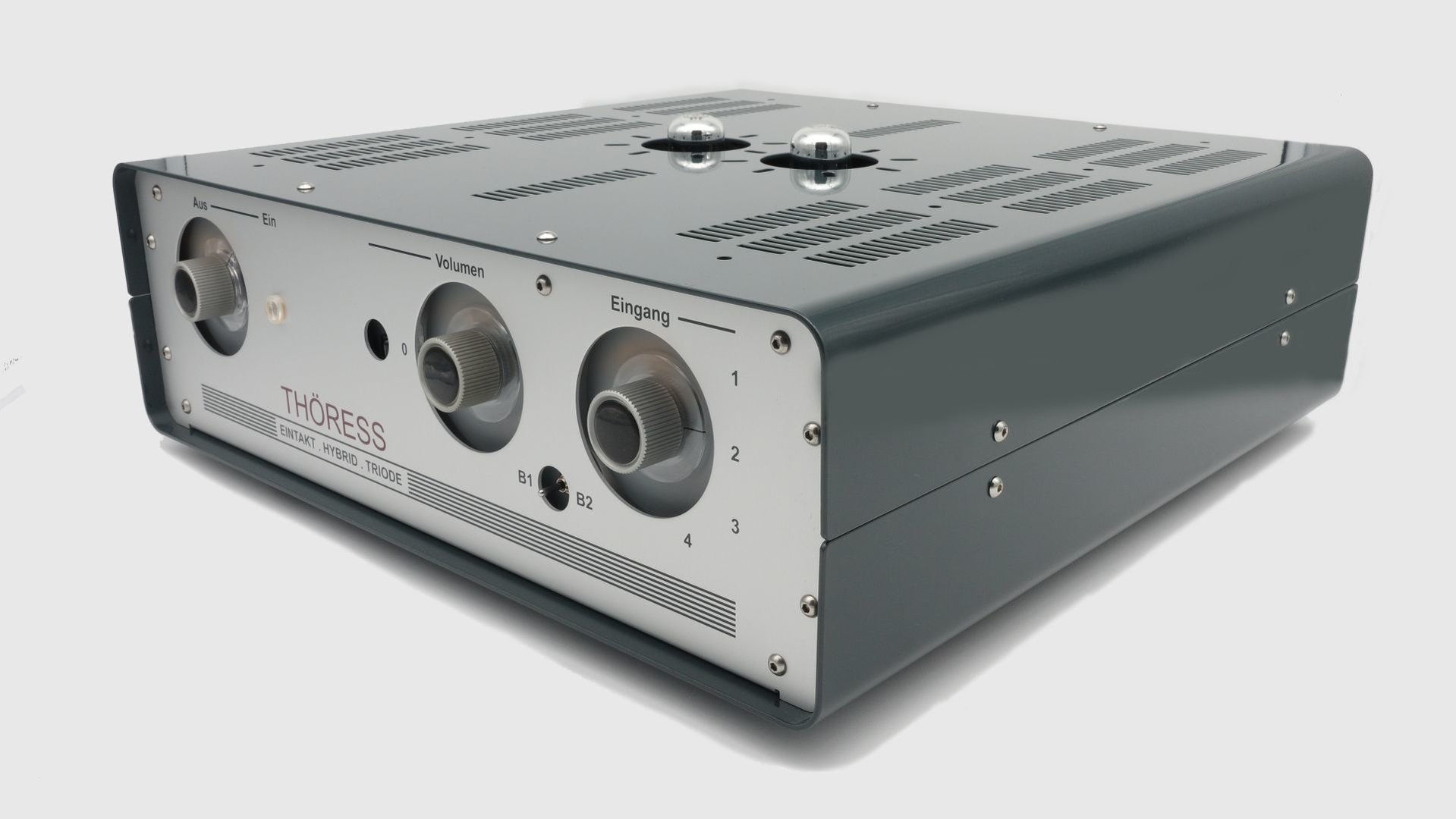

Thøress integrert forsterker Med fjernkontroll.
Kan du klare deg med 18-20W så er dette en av de beste forsterkerene jeg har hørt. Denne er rett og slett magisk, og med lettdrevne høyttalere så låter alt helt rett. Dette er håndlagde forsterkere som er gjort på rette måten. Ingen printkort og gjennomgående skyhøy kvalitet.

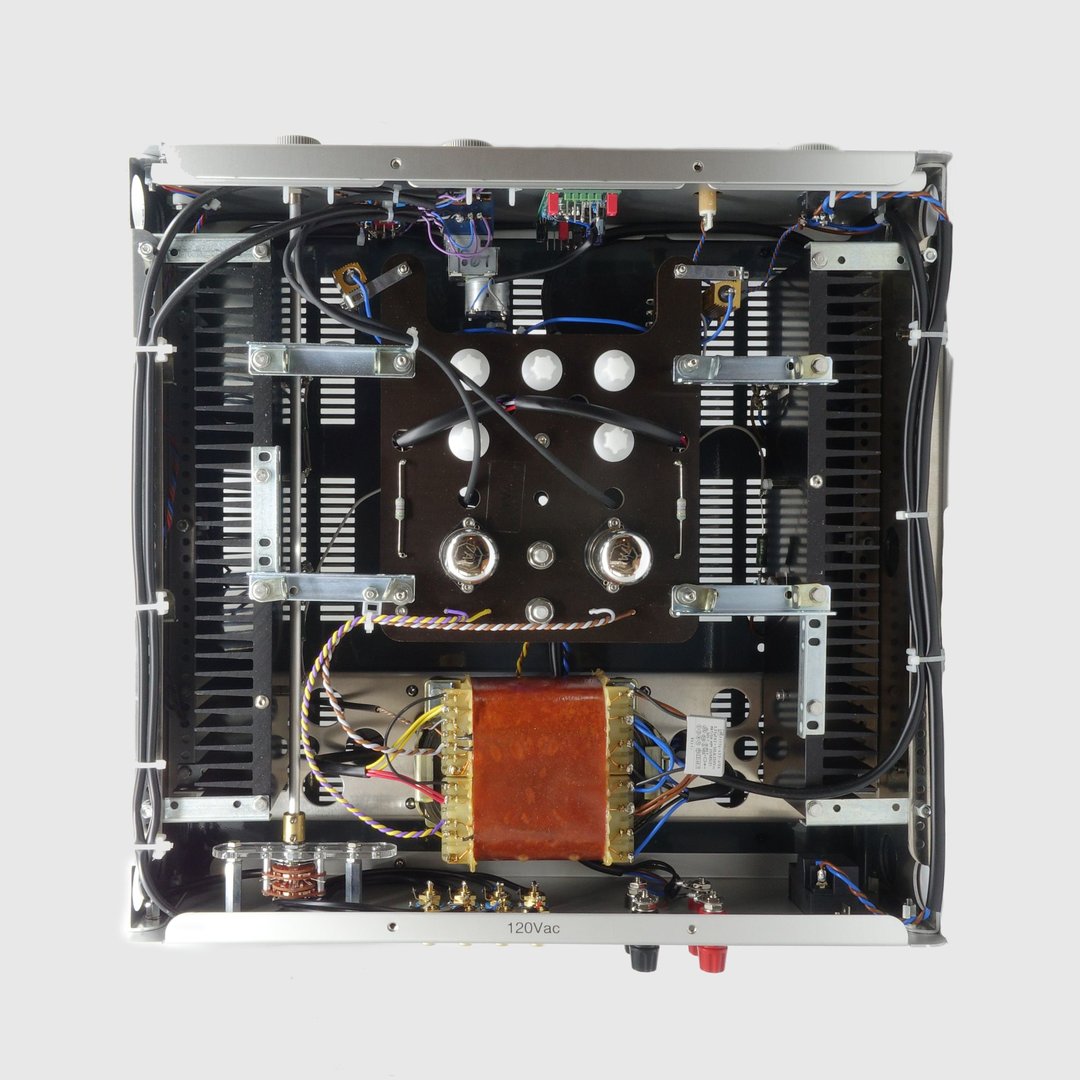

The amplifier is built with meticulous hand construction using our proven point-topoint wiring techniques, whereas much care has been taken in arranging each aspect of the internal construction to ensure low noise performance, ease of service and the highest reliability for many years to come. It is an ultimate component in every sense and as such a perfect complement to our Parametric Phono Equalizer (Phono Enhancer). Particularly when combined with our under-hung voice-coil 1D66 or horn based 2CD12 loudspeaker the sonic presentation of the EHT Mono Blocks is of the utmost refinement which will certainly meet the expectations of even the most critical and experienced music lover.

The EHT Integrated Amplifier is equipped with a proprietary mains transformer produced in-house to ensure the highest possible quality and reliability. This part features a highly elaborated dual-coil winding on a large tape wound cut core (Ccore) and has been optimized for low body noise emission and low leakage. Nevertheless, the mains transformer is mounted to the chassis via isolation elements in order to eliminate even the slightest interference of residual transformer vibrations with the circuit. Since the mains transformer is produced inhouse

 Full hand construction, point-to-point wiring throughout.
