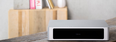

The Musicbook POWER is not only the ideal game partner for the Musicbook SOURCE, but also knows how to get even the finest musical details out of a loudspeaker. Of course, with excellent measured values and minimal power consumption.

The Musicbook POWER is a real allrounder and can be combined with virtually all kinds of loudspeakers. Speakers with a average or high sensitivity are already perfect game partners for the Musicbook POWER 500. For speakers with a low sensitivity or low impedance we recommend the Musicbook POWER 1000 which can ”push out” more than 20 amperes of current.

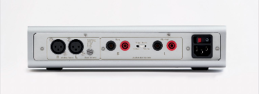

Technical specifications
Please note: The values in brackets apply to the POWER 1000!
General
Mains connection: 90-240 V, 50/60 Hz
Power consumption: 0,5 W stand-by, 9 (16) W operation, 650 (1200) W max.
Dimensions (W x H x D): 280 x 220 x 63 mm
Weight: 2,9 (3,4) kg
Power amps
XLR Inputs: analog line-level inputs
Input voltage for full modulation: 1,68 V (2,38 V)
Input impendance: 50 kOhms
Speaker outputs: banana plugs (4 mm)
Speaker impendance range: 2 – 8 Ohms
Output power: 2 x 250 W @ 4 Ohms (2 x 500 W @ 4 Ohms)
Gain: 25,5 dB
THD: < 0,003%
Frequency response: 1 Hz – 45 kHz (-3 dB)
Signal-to-noise ration: > 110 dB
Automatic switch-on
Switch-on treshold: ca. 0,5 mV balanced
Switch-on delay: ca. 2-3 seconds
Switch-off time: ca. 75 minutes
Protection circuits
DC at output: Amp shuts down. Must be disconnected from mains and switched on again. LED is permanently on red.
Overtemperature: LED flashes red. In case of further temperature rise, the amp is muted until the temperature is back to normal again.
Current limiting: Amp is muted. Output current switching treshold: 17,5 A (27 A).
